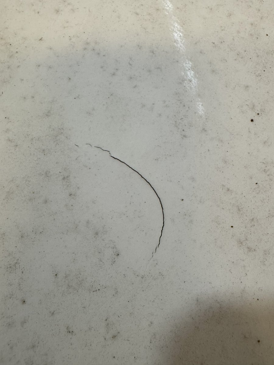

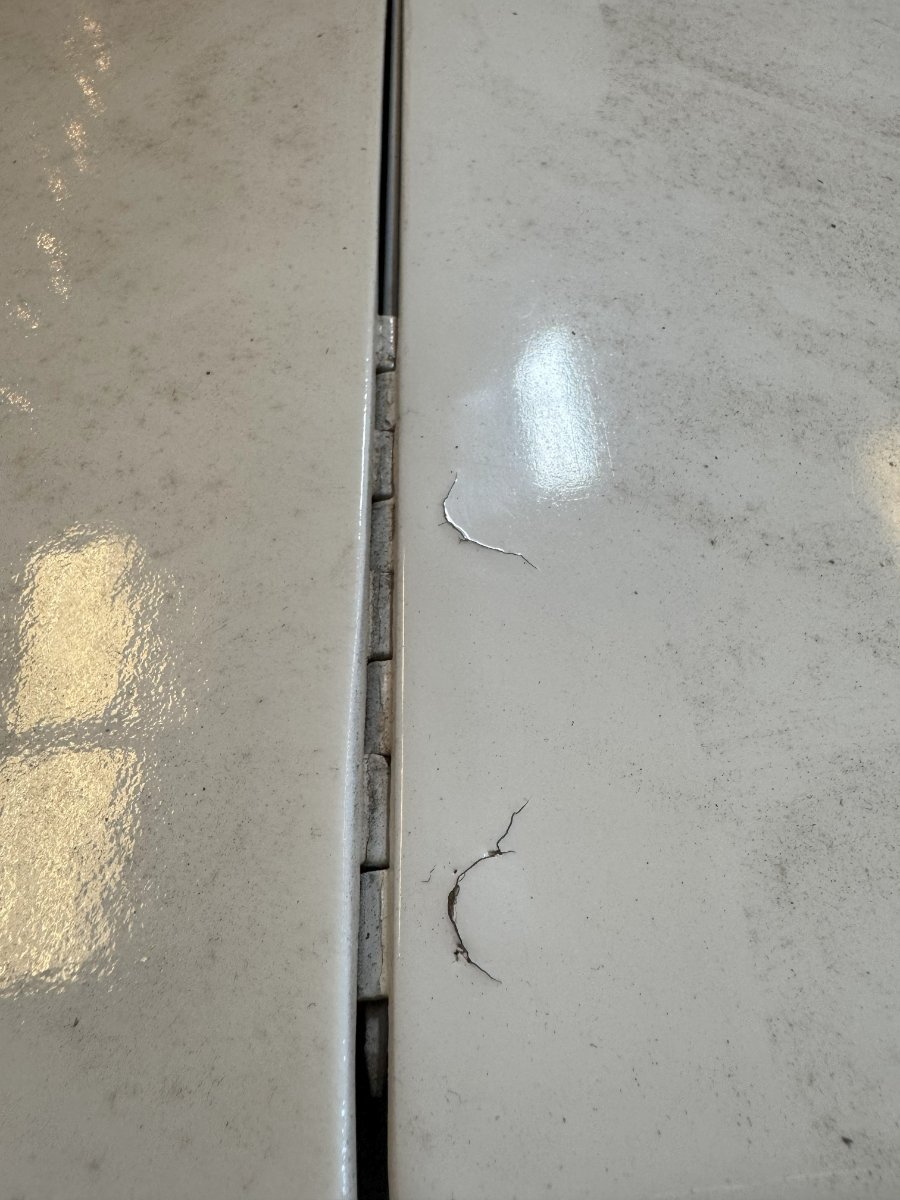

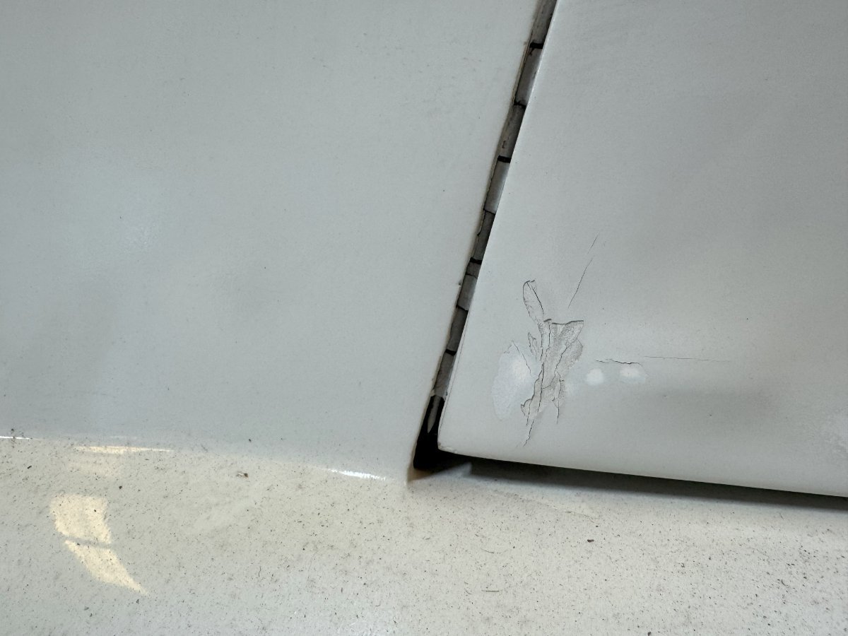

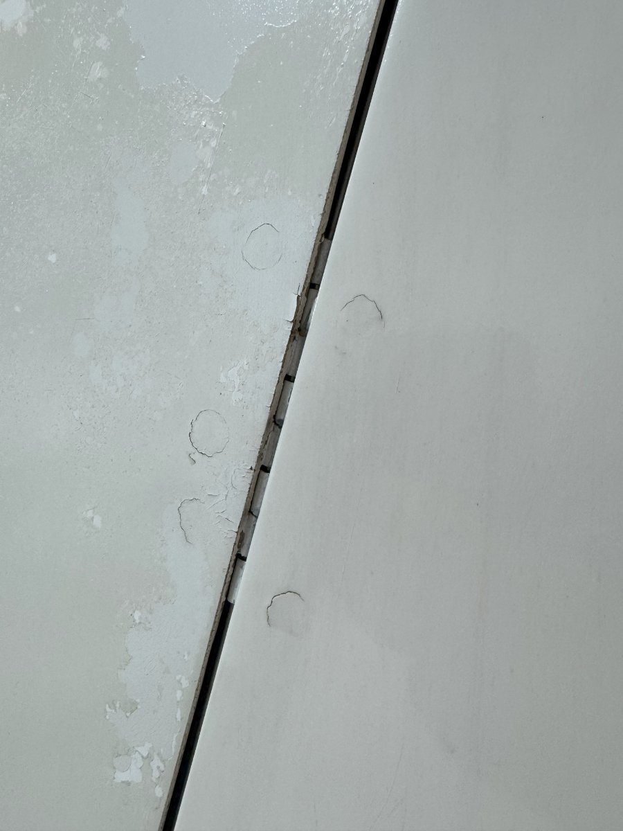

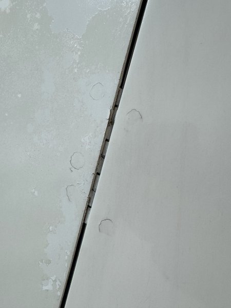

MissionaryPilot Posted December 2 Posted December 2 IMG_2839.HEICIMG_2839.HEICIMG_2838.HEICIMG_2837.HEICIMG_2836.HEICIMG_2835.HEIC Our ministry was donated a 230. I noticed these areas on the empennage. Can anyone tell me if theee is common? And the best method for fixing these type issues.
turboplanner Posted December 2 Posted December 2 23 minutes ago, MissionaryPilot said: IMG_2839.HEIC 1.54 MB · 3 downloads IMG_2839.HEIC 1.54 MB · 3 downloads IMG_2838.HEIC 1.39 MB · 0 downloads IMG_2837.HEIC 1.04 MB · 0 downloads IMG_2836.HEIC 1.39 MB · 1 download IMG_2835.HEIC 1.32 MB · 1 download Our ministry was donated a 230. I noticed these areas on the empennage. Can anyone tell me if theee is common? And the best method for fixing these type issues. Send those photos to Jabiru and ask for advice. The issue may simply be filler shrinkage over the rivet heads, or it may indicate movement at some stage due to hinge binding. This may be inexpensive to repair but let Jabiru see it just to make sure its not a structural issue. 1

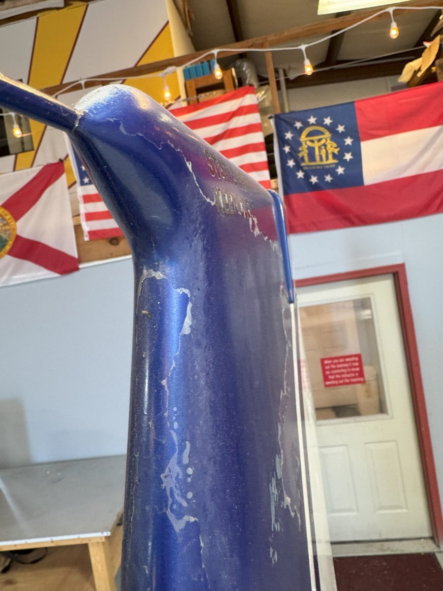

facthunter Posted December 4 Posted December 4 The Blue one is only the clear coming off. I don't like using it, but it's common these days. You can't blend a repair in.. Keep paint thin on Aircraft. Especially FABRIC covered which causes cracking. Nev
