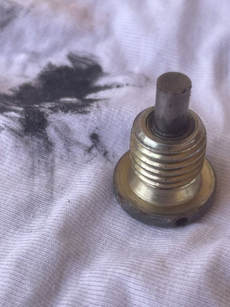

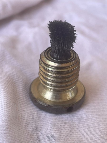

Moneybox Posted January 22 Posted January 22 On 22/01/2025 at 11:54 AM, Blueadventures said: Depends on when you do your filter; I change oil at 50 and filter at 100. At 100 also lube the muffler to header ball joints on mine so if you have ball joint type connections you may consider relubeing them at 100 with the specified lube. Mine is S/S so use Koppa Kote / Copper slip lube. Steel Rotax require one of the nickle anti seizes. have you had the magnetic plug out, it has a torx female and they can be a real pain and then you need to buy the upgrade hex head one a 16mm / 5/8” ring spanner fits. Expand No I've not removed that. You suggest I do it now while I have easy access? 2
Blueadventures Posted January 22 Author Posted January 22 On 22/01/2025 at 12:12 PM, Moneybox said: No I've not removed that. You suggest I do it now while I have easy access? Expand Yes I would, two reasons one to see any fur, filing on it and to know it can be undone. It’s a torx drive not Allen key. If it’s hard to undo try some hammer taps and vice grips to loosen. There no washer or copper washer under it just a metal to metal fit. Cheers 1 4

Blueadventures Posted January 22 Author Posted January 22 On 22/01/2025 at 1:01 PM, Moneybox said: Yes obviously a problem. http://www.rotax-owner.com/all-videos/expanded-video-instructions/295-magplug I'll sort it out tomorrow. Expand That is about inspection of it; do a google of 'unable to remove magnetic plug' and rotax owner will have some methods of removal. I came across a stubborn one before Xmas while doing an oil change. Owner is getting a new mag plug hex head from floods and then the old one will be removed and inspected and the new one fitted. I hope for you that yours is free it takes a #40 Torx and make sure its fully in when turning as they strip out easily and that's why Rotax upgraded the plug. 1
facthunter Posted January 22 Posted January 22 Best way to loosen them is to get a Brass drift with good flat ends and give it one good hit/tap straight on with an engineers hammer.. Most people over tighten these things,. (Butchers) Nev

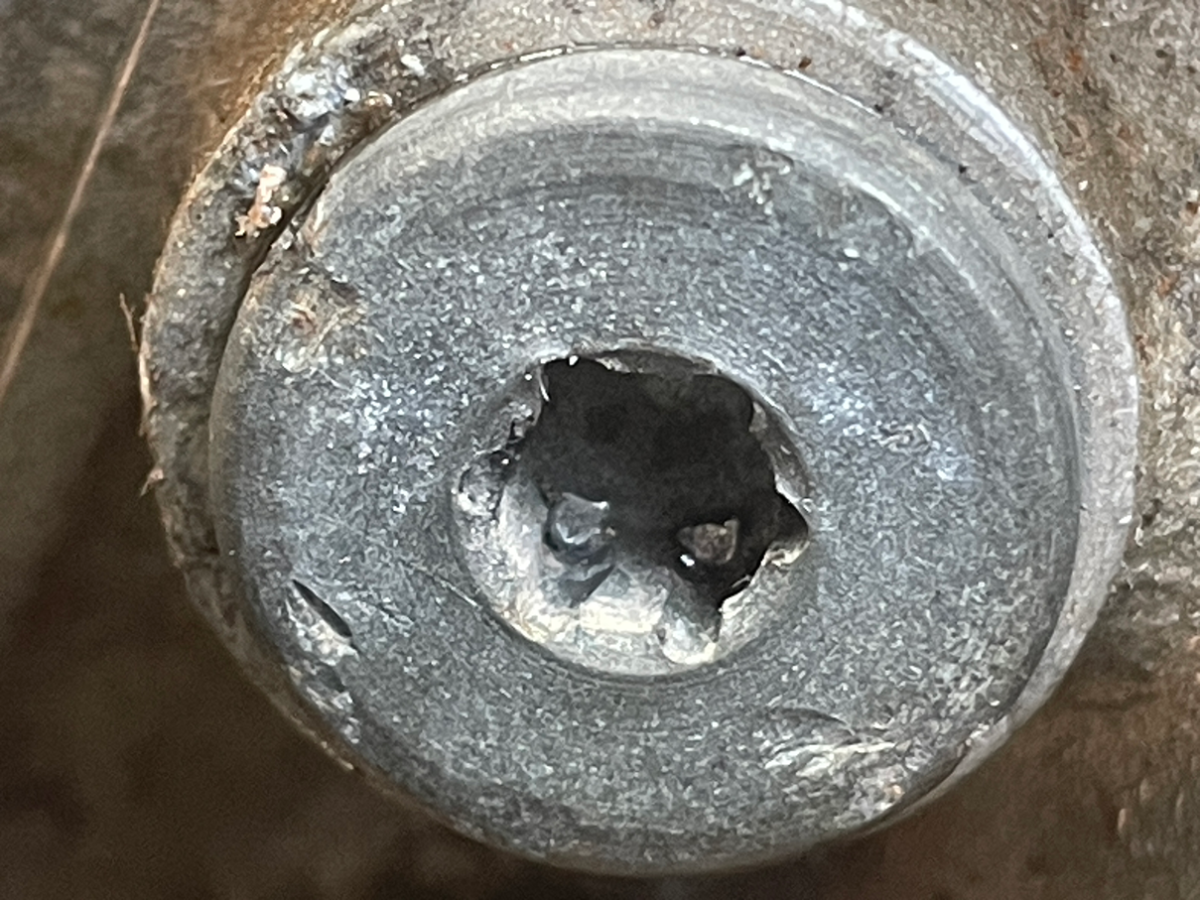

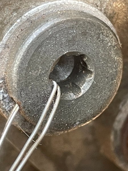

Moneybox Posted January 23 Posted January 23 Ok I've looked at that. The reason they strip is that it's a lousy Torx with no grip. When you tap the Torx key in it deepens to grooves and gives you a bit better chance of loosening it. It's a bit furry but looks worse than it really is, nothing like 3mm which is the limit. There are no lumpy bits. It was just like a paste so I'm not concerned about that. We'll see next time 😉 And guys, I'd appreciate all those instructions before I fit the exhaust 🤣 2

Blueadventures Posted January 23 Author Posted January 23 On 23/01/2025 at 1:07 AM, Moneybox said: Ok I've looked at that. The reason they strip is that it's a lousy Torx with no grip. When you tap the Torx key in it deepens to grooves and gives you a bit better chance of loosening it. It's a bit furry but looks worse than it really is, nothing like 3mm which is the limit. There are no lumpy bits. It was just like a paste so I'm not concerned about that. We'll see next time 😉 And guys, I'd appreciate all those instructions before I fit the exhaust 🤣 Expand Well done, may never have been taken out. May be do an oil change at 15 - 20 hours and recheck plug then. Glad it came out for you. I've never put a copper washer under them or seen such. Cheers. 1 1
facthunter Posted January 23 Posted January 23 I would not like to see it keep shedding steel. Keep checking it. The oil is doing a big job in there. Nev 2
Moneybox Posted January 23 Posted January 23 (edited) On 23/01/2025 at 1:57 AM, facthunter said: I would not like to see it keep shedding steel. Keep checking it. The oil is doing a big job in there. Nev Expand Any magnetic plug will collect fine particles over time and I have no idea how long its been there. The paper from the oil filter was clean, not a fragment of metal or anything else I could see. Some of these engines had a faulty propeller shaft that would shed metal. This one is not amongst those serial numbers so I'm happy to wait for the next inspection after its done some work. I didn't fit a washer, nor did I over tighten it. Edited January 23 by Moneybox 1
facthunter Posted January 23 Posted January 23 They only collect steel Particles. It should not keep happening . The magnets are good as indicators of WEAR of CERTAIN parts. and also remove the particles from circulation Nev 1

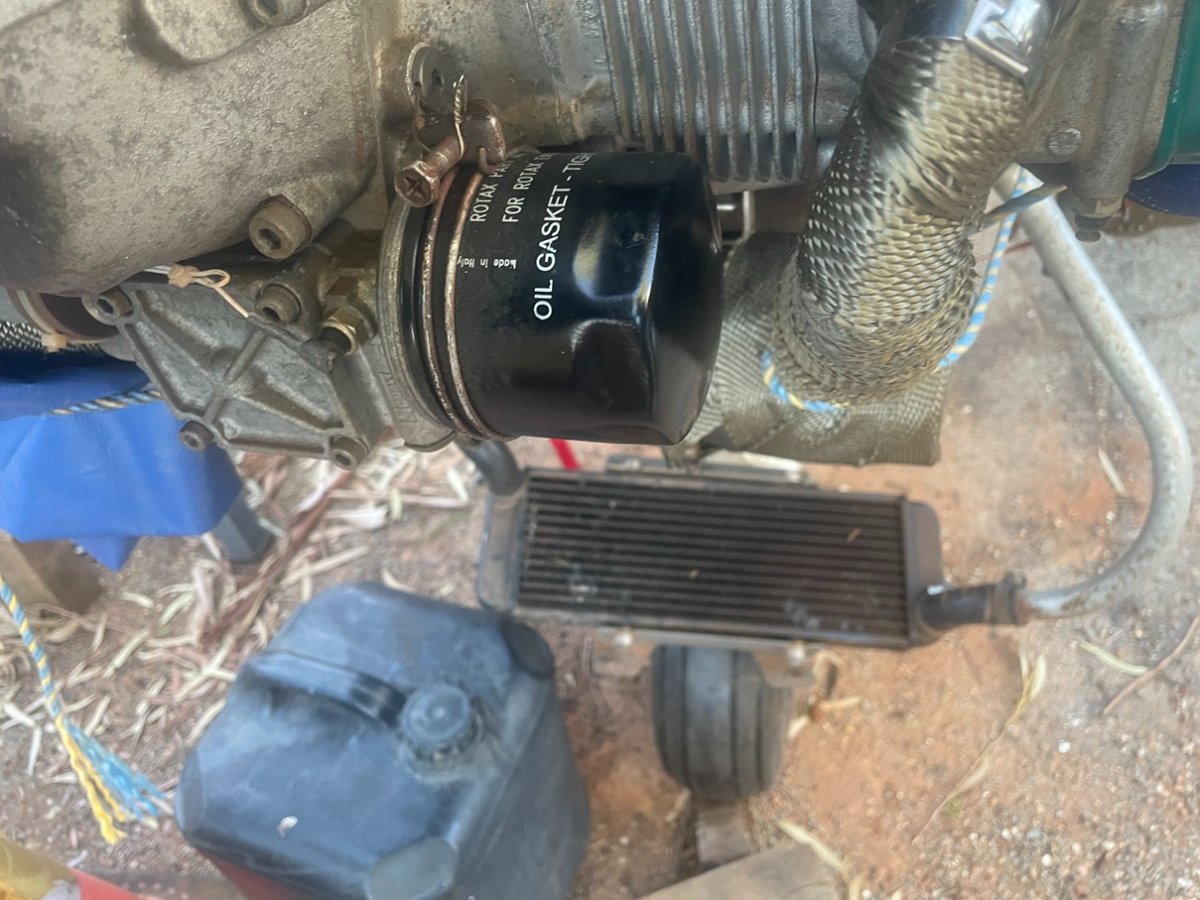

Red Posted January 23 Posted January 23 (edited) On 22/01/2025 at 10:59 AM, Moneybox said: I was pleasantly surprised when my 30mm SS exhaust tube and flex turned up in the post this morning. Now I think I have clearance to remove the oil filter too. How could they produce a fault like that and continue to manufacture it until a couple of years later they come out with a new exhaust system. That hose on the radiator comes too close when its in place (another bulletin) so I have some tubular insulation on the way for that as well. Expand MB, that looks like a very old type of Rotax filter that was changed many years ago to a slightly taller type..check it 825016 Is the current part number (Replaces 825012) Edited January 23 by Red
Moneybox Posted January 23 Posted January 23 (edited) On 23/01/2025 at 12:12 PM, Red said: MB, that looks like a very old type of Rotax filter that was changed many years ago to a slightly taller type..check it 825016 Is the current part number (Replaces 825012) Expand Recently purchased from Bert Flood. I'll take a look in the morning. Just took a look at the invoice. I got two x 825016. Perhaps it's just the extra clearance I've given it with the remodeled exhaust pipe on No.2. I shouldn't have to move the pipe next oil change. Edited January 23 by Moneybox
Moneybox Posted January 23 Posted January 23 The filter looks a bit grubby but that's because I gave everything a good coat of ACF50 to help with things like that hose clamp on the filter. It mightn't look good but everything has an oily film that will probably give it a bit of corrosion protection. 1
