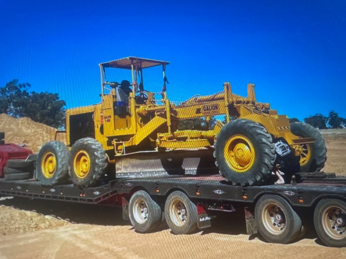

Moneybox Posted January 28 Posted January 28 Meet Ripper. It already has a name and we haven't seen it yet. I've just organised the freight..... 😀 3 1 4

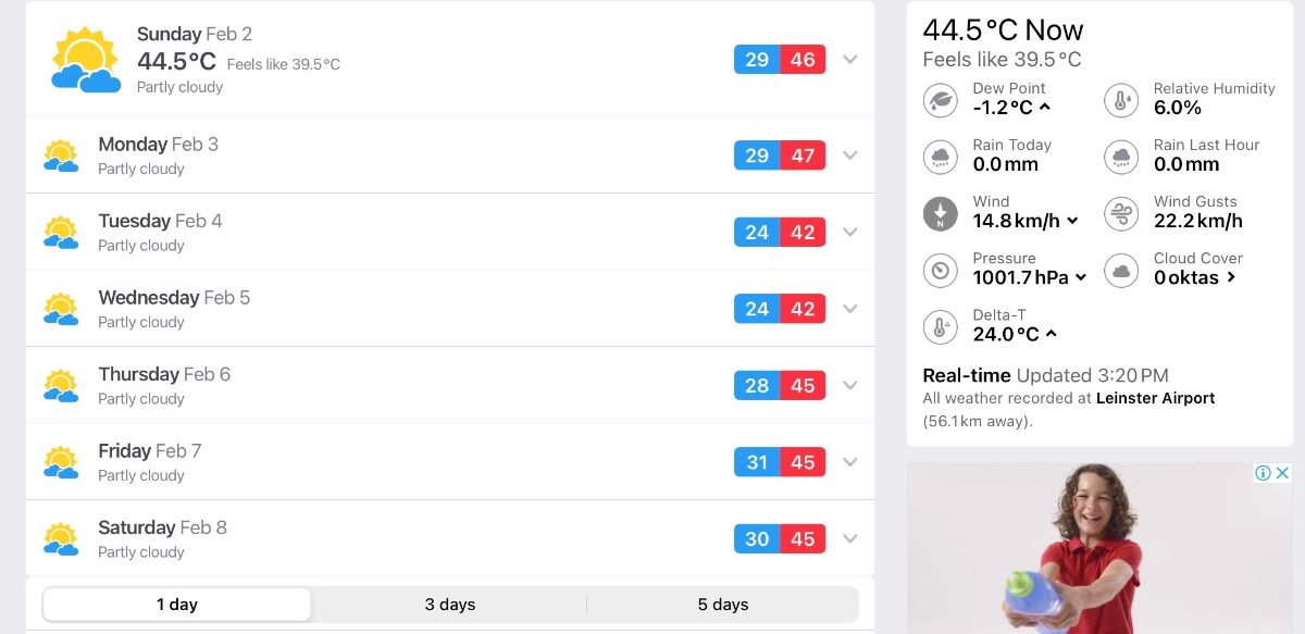

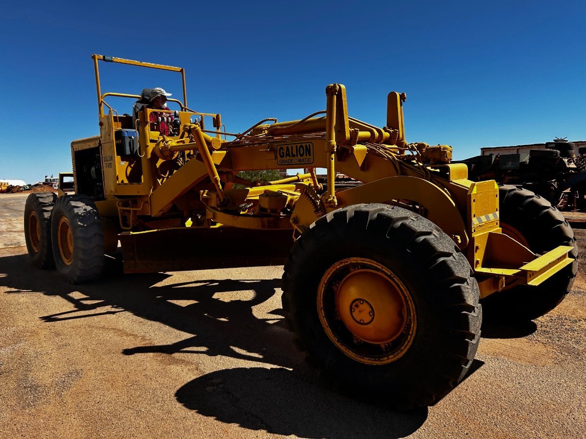

Moneybox Posted February 2 Posted February 2 Yesterday we took possession of Ripper and left it in a vacant paddock waiting for transport. I hope it doesn’t have to wait too long. The temperature here is pretty much unbearable. We’re not finding much gold so if it doesn’t improve we’re heading home tomorrow. 1 1
Thruster88 Posted February 2 Posted February 2 1 minute ago, Moneybox said: Yesterday we took possession of Ripper and left it in a vacant paddock waiting for transport. I hope it doesn’t have to wait too long. The temperature here is pretty much unbearable. We’re not finding much gold so if it doesn’t improve we’re heading home tomorrow. Will you use ripper, the Gallion stallion in your gold prospecting after building the runway? I believe metal detection people use them to strip off the surface layer. 2 1
onetrack Posted February 2 Posted February 2 Don't work that old Gay-lion too hard, the last rigid-frame Galion was built nearly 40 years ago, and sourcing new parts might be a little difficult today! 1 1
Moneybox Posted February 2 Posted February 2 5 hours ago, Thruster88 said: Will you use ripper, the Gallion stallion in your gold prospecting after building the runway? I believe metal detection people use them to strip off the surface layer. I’ve always wanted a dozer or grader for scrape and detect but couldn’t justify the price. Now I’ve sold the big lease where I needed it so that I could finance my flying. I’ve got other ground I’d like to use it on but moving it around is expensive. Just getting it home is more than $6000. To pay freight moving it to a gold lease I have to sum up the cost of freight, fuel and return freight. I’d need to be sure to find a lot more gold. For now Ripper is going to be busy building an airstrip 😅 4

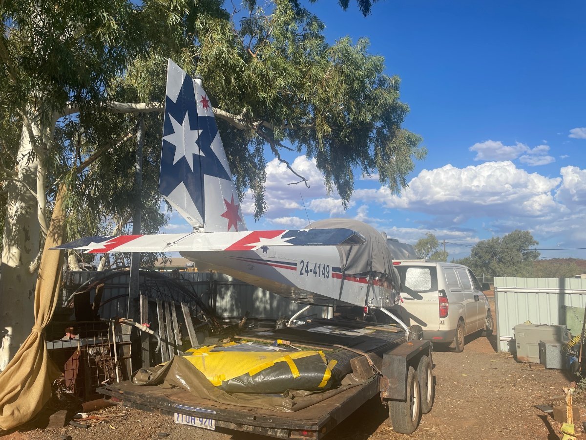

Moneybox Posted February 19 Posted February 19 All loaded for the trip south. We only got home last night. I plan to lift it of in Northam and put the wings on. My LAME will fly up to there and inspect it. 2
Moneybox Posted February 19 Posted February 19 Ripper came home yesterday. After parking it at Ora Banda I thought I should have removed the brand new Kings fridge but we were too far away when I thought about it. I was quite pleased when I jumped up there and saw the fridge still in place. Them my mood took a bit of a dive when Mrs M said "Where's the roof"? The canopy must have been a lift-off device so lifted off somewhere between Ora Banda and Cue. The solar panel has gone as well. 1 2
