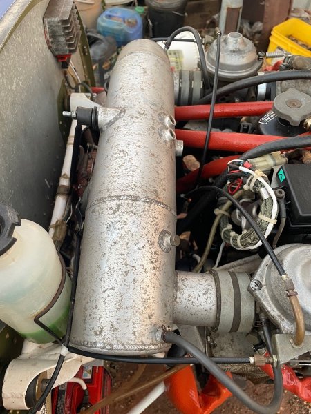

skippydiesel Posted Saturday at 11:34 PM Author Posted Saturday at 11:34 PM I only need about 30-40 mm flexible (must not transmit any load/restricton on the carb) straight (no bends) ducts between my air box & carburettor flange. Despite my hope, the SCEET does not seem to be the right choice for the job. Suggestions welcome.😈

skippydiesel Posted Sunday at 02:49 AM Author Posted Sunday at 02:49 AM (edited) Most of the silicon hose/ducting, I have found on the net, is quite heavy & thick - aimed at intercooling & the like. I specifically need, lightweight, good hear/fuel resistance & as flexible as possible so as not to impact on the carburettor being able to move/absorb vibration. I may have to use SCAT with the coil removed. I have written to a lay flat fuel hose supplier that has the necessary 51 mm(2") ID hose which may be suitable. In the meantime I have some Gates, automotive, aluminium, concertina ducting that will do the job for a while (longer?)😈 Edited Sunday at 02:51 AM by skippydiesel 1

facthunter Posted Sunday at 05:17 AM Posted Sunday at 05:17 AM Does the Airbox move with the engine?. IF it doesn't you will need great flexibility as the distance is short That means neoprene and maybe go to a bigger diameter if flow concerns you. Use bellows type. Nev 1 1
skippydiesel Posted Sunday at 10:08 AM Author Posted Sunday at 10:08 AM (edited) Saved by another pilot. Called in to the Sydney Recreational Flying Club, on the way to my Sonex - mentioned the need for small amount of 2" (51mm) ID SCAT. A member & gentleman, said he had he had some unused pieces I could have, he drove drove off, returning an hour later with the stuff. How good is that??? I used the donated SCAT, minus wire, to make two short (35mm) cuffs. Fitted perfectly to airbox/carbs, with a small amount of slack in middle for movement & secured with nice thin hose clamps - job almost done. Looking good. Will finish off during the week & go fly. My thanks, to all those who made suggestions/gave advice😈 Edited Sunday at 10:09 AM by skippydiesel 3
Thruster88 Posted Monday at 01:41 AM Posted Monday at 01:41 AM Skippy, without the inner wire the scat hose will most likely collapse, I realise the very short length won't allow a complete collapse. 1 3

skippydiesel Posted 23 hours ago Author Posted 23 hours ago Thanks All, Air inlet/box/filter & new cuffs all installed. Test fly at earliest opportunity. On 27/01/2025 at 12:41 PM, Thruster88 said: Skippy, without the inner wire the scat hose will most likely collapse, I realise the very short length won't allow a complete collapse. Thanks Thruster - Gap between air box & carburettor flange less than 5mm. I don't anticipate any negative impact from hose being "sucket in" a little. I have left a small fold in the cuff, at/in the above gap to facilitate relative movement. Static testing (moving carb or airbox ) seems to indicate idea is working. The previous cuff was 2" ID fuel hose, relatively (to the SCAT, less wire) stiff/unyielding.😈 1 1
Moneybox Posted 23 hours ago Posted 23 hours ago 16 minutes ago, skippydiesel said: Thanks All, Air inlet/box/filter & new cuffs all installed. Test fly at earliest opportunity. Thanks Thruster - Gap between air box & carburettor flange less than 5mm. I don't anticipate any negative impact from hose being "sucket in" a little. I have left a small fold in the cuff, at/in the above gap to facilitate relative movement. Static testing (moving carb or airbox ) seems to indicate idea is working. The previous cuff was 2" ID fuel hose, relatively (to the SCAT, less wire) stiff/unyielding.😈 Mine has that heavy reinforced rubber hose as well and the back of the airbox has one small rubber mount back to the engine mounting frame. 1
Moneybox Posted 23 hours ago Posted 23 hours ago 4 minutes ago, Moneybox said: Mine has that heavy reinforced rubber hose as well and the back of the airbox has one small rubber mount back to the engine mounting frame. No come to think of it, the back of the airbox is supported by a 6mm steel rod from the firewall up to the small rubber mount just giving it vertical support. 1
