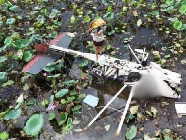

onetrack Posted Tuesday at 06:45 AM Author Posted Tuesday at 06:45 AM Struts, tailplane, and fuselage all appear to be largely intact. Frontal damage appears to indicate a nose-dive straight into shallow water in the dam. The woman is lucky to have escaped unhurt. Photo is courtesy of the NT News. 3
facthunter Posted Tuesday at 06:48 AM Posted Tuesday at 06:48 AM (edited) All intact Even the wheels. Front immersed in the water?? Nev Edited Tuesday at 06:51 AM by facthunter 1

facthunter Posted Tuesday at 07:06 AM Posted Tuesday at 07:06 AM Maybe the front is damaged I can't tell but not much else is. Being upside down in the water is NOT a place to be especially IF it's shallow and muddy. Nev 1

Thruster88 Posted Tuesday at 08:39 AM Posted Tuesday at 08:39 AM Aircraft is in the raaus accident database. A forced landing into those water lily's would result in inversion every time. Drag on the undercarriage, sharp nose goes in, momentum flips the aircraft. Rear seat has protection from structure and the wing, would make getting out more likely. 1 3

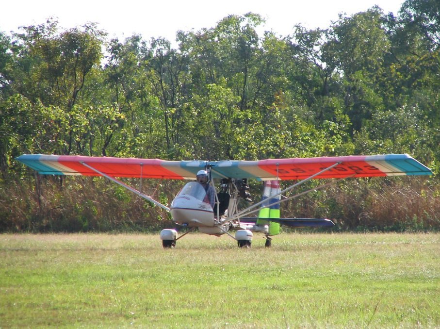

onetrack Posted Tuesday at 08:50 AM Author Posted Tuesday at 08:50 AM (edited) The aircrafts registration was 55-1903. Photo courtesy of Ken Hodge on Flickr. Accident Austflight Drifter SB582 55-1903, Sunday 12 January 2025 ASN.FLIGHTSAFETY.ORG An Austflight Driter SB582 crashed into the waters near Fogg Dam, south east of Darwin. <br />The pilot perished and the passenger was injured and the ultralight was written off. Edited Tuesday at 08:53 AM by onetrack 2
rankamateur Posted Tuesday at 09:24 AM Posted Tuesday at 09:24 AM (edited) 1 hour ago, turboplanner said: Numbers under the wing. I was thinking of Wayne Fisher with the VH under the wing. It did stuff we are discouraged from doing under RAA. Numbers were a bit hard to read under muddy water. Little more obvious in the later posted photo. Edited Tuesday at 09:26 AM by rankamateur 1

FlyBoy1960 Posted Tuesday at 09:13 PM Posted Tuesday at 09:13 PM 15 hours ago, T510 said: He may have held a Low Level Endorsement in which case he could have legally flown under 500ft AGL https://raaus.com.au/learn-to-fly/endorsements/low-level/ He may have held a low-level endorsement but, you can't use that endorsement for just flying around like depicted in the video. The low-level endorsement is for very specific tasks ONLY like checking on your own stock on a cattle property etc. It is not for joy flights scaring the pretty young thing in the backseat. If you look at the photograph you can see they have blurred out the pilots body, and she is standing on top of the aircraft. Imagine her fear knowing that the life of the pilot has been extinguished and every noise or rustle she hears in the swamp could be a crocodile coming to get her. She has, without any choice or actions of her own, had to endure stress's that many people could not handle. My heart goes out to the pilot and his family, but it also goes out to this young lady who is obviously going to be suffering with this trauma for a very considerable time and I hope gets assistance that she needs or requires. 4 1 1
