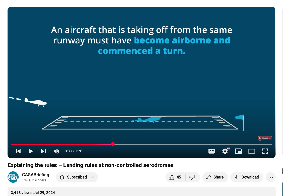

Garfly Posted January 24 Posted January 24 I've been checking out the recent CASA video series "Explaining the rules". Some are sort of useful but this one "Landing Rules at non-controlled aerodromes" has me confused. https://www.youtube.com/watch?v=2EkQagUcwNY&list=PLjm7k4QRw7_spKGYzGOkxBwrWiaDr-srd&index=5 In it, these two slides are shown, one after another. Am I missing something? How is it that these two "explanations" both apply? It's not like there's an "and/or" involved (but even if there was ...??). Anyway, if version 1 wins out, what happens when the aircraft ahead departs upwind?
turboplanner Posted January 24 Posted January 24 2 minutes ago, Garfly said: I've been checking out the recent CASA video series "Explaining the rules". Some are sort of useful but this one "Landing Rules at non-controlled aerodromes" has me confused. https://www.youtube.com/watch?v=2EkQagUcwNY&list=PLjm7k4QRw7_spKGYzGOkxBwrWiaDr-srd&index=5 In it, these two slides are shown, one after another. Am I missing something? How is it that these two "explanations" both apply? It's not like there's an "and/or" involved (but even if there was ...??). Anyway, if version 1 wins out, what happens when the aircraft ahead departs upwind? Good pickup; email CASA. The VFRG should show the correct one.
clouddancer Posted Friday at 08:07 PM Posted Friday at 08:07 PM They are both correct, it is an either, or, kind of scenario. either the aircraft taking off had turned onto crosswind, or it is climbing straight ahead and is further along the runway and you can finish your landing roll. simples. 1 1
Garfly Posted Friday at 09:53 PM Author Posted Friday at 09:53 PM 12 minutes ago, clouddancer said: They are both correct, it is an either, or, kind of scenario. either the aircraft taking off had turned onto crosswind, or it is climbing straight ahead and is further along the runway and you can finish your landing roll. simples. Simples? But there's no suggestion of any either/or scenarios in the video. The commentary names both as "certain criteria" that must be met. (Not either one criterion or another). "You must not continue approach to land beyond the threshold of the runway until you meet certain criteria. These are: • An aircraft that is taking off from the same runway must have become airborne and commenced a turn. • An aircraft that is taking off from the same runway must be beyond the point at which your aircraft could be expected to complete its landing roll." But, in any case, even if we put it down to clumsy language/video production, how is this of any guidance in the real world? Taking your first scenario - an aircraft that's already taken off, climbed to 500' and turned crosswind then clearly it's no factor. It's everyday circuit work. As to your climbing straight ahead case, at most uncontrolled strips you'd be clearing the far end before turning anyway so that scenario only counts if, turning final, you felt compelled to apply the video's first criterion strictly. (No turn, no land!) But then, looking at the wording of the second of the two criteria, it seems it doesn't even require the aircraft ahead to be airborne in its take-off run - just so long as you reckon you can pull up in time if, say, he suddenly aborts. To me it doesn't look simple at all. It looks like a super stringent rule running concurrently with a really quite liberal one - applied to the same scenario. Take your pick? 1
Moneybox Posted Friday at 11:14 PM Posted Friday at 11:14 PM Sure seems confusing however you approach it. One way the previous aircraft is so far beyond range it's hardly worth mentioning and the next you're setting yourself up for a nasty surprise if he chooses to taxi back up the runway. Anyway I enjoyed sitting watching as it flicked from one short informative to the next. I left it open because I want to watch more. 1 1
