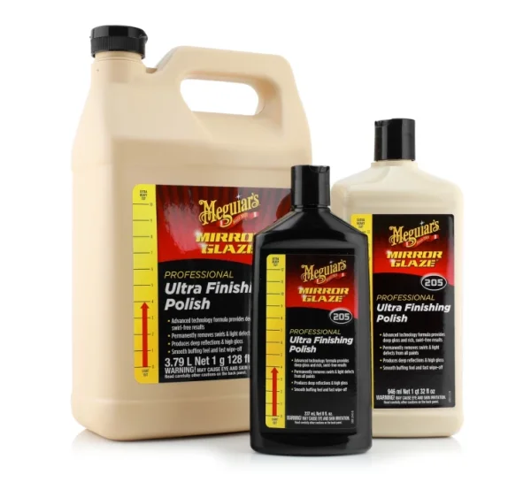

Blueadventures Posted 18 hours ago Posted 18 hours ago I give mine a hand cut / polish / wax with a good quality Meaguires product about twice a year; just keep off any decal areas. Starbrite is more like a water stain remover. I'd try the hand polish on an under surface; it should work and most likely you will always notice a different shade where the decals were. Paul or Mark Hilton will have some ideas especially Mark as they restore and repair a lot. 1
