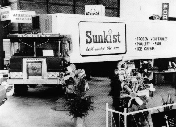

turboplanner Posted January 30 Posted January 30 17 hours ago, facthunter said: The RESIN is the reason.. It's not forever. Nev The resin is the critical component and this paper by Sindhu & Joseph gives some data on the subject. There are many resins available and many standards on sale. Whether Oxidation, UV, chemical splashed etc, some products crack or colapse to a powder and the laminate is just a heap of glass fibres and powder. You can see that a lot in cheap boats which have been made with cheap resin and thin laminates. At the other end of the scale are products like these Atkinson FRP Truck Cabs and FRP Refrigerated Vans. There are still plenty in operation after 55 - 59 years. The FRP Refrigerated rigid trucks have had several refrigeration unit replacements and some are on their 7th truck cab/chassis. 1 1
skippydiesel Posted January 30 Posted January 30 Hi Turbs, I am impressed by the durability of your FRP examples. I am now more curious; Does the type of "damage" suggest the type/quality of the composite? eg Jabs out in the weather look a little dull, but seem to be structurally sound. Can the surface damage be categorised into surface only - indication of deeper problems? With Ninja - I understand that the fuselage is made up of composite panels over an alloy frame, so it's likly that any composite deterioration, is more of an esthetic than a safety issue? 1
turboplanner Posted January 30 Posted January 30 36 minutes ago, skippydiesel said: Hi Turbs, I am impressed by the durability of your FRP examples. I am now more curious; Does the type of "damage" suggest the type/quality of the composite? eg Jabs out in the weather look a little dull, but seem to be structurally sound. Yes laminate in high quality resin will retain its memory (springyness) longer. If you press your thumb against the side of a new Jab, you can do a basic gauge comparison with a similar thickness curved laminate of poor quality resin and your thumb will go in deeper and the material will tank longer to rebound. 36 minutes ago, skippydiesel said: Can the surface damage be categorised into surface only - indication of deeper problems? With a gelcoat/polyester/chopped strand mat fibrelass laminate (very roughly here) Stage 1 Dull surface of gelcoat (gelcoat problem - polish or cut and polish) Stage 2 Dull Plus surface powder (as 1 but can be deteriorating in the laminate also) Stage 3 Tiny cracks, crazing (through the gelcoat ad water getting into the laminate - structural damage starting) Stage 4 Bigger cracks, big long lines of crazing. When the laminate bulges these cracks open and let the weather in. At the very least the gelcoat needs sanding off and replaced). Stage 5 Chunks of gelcoat dropping off between the Stage 4 cracks and crazes, more rapid deterioration of the resin and a lot more softening. Stage 6 Areas of resin crazing into small squares and dropping out of the fibreglass fibres. Inspecting for Stages 3,4 you would be doing a lot of thumb pushing. 36 minutes ago, skippydiesel said: With Ninja - I understand that the fuselage is made up of composite panels over an alloy frame, so it's likly that any composite deterioration, is more of an esthetic than a safety issue? This is where you can't generalise; you have to go back to the individual manufacturer. They might all be using fibreglass but the engineering, specifications etc will all be different. When the weather has got into the laminate, a monocoque structure is virtually at the point where you have to throw it away. Even with a space frame for structural strength deteriorated panels will be torn off their mountings or collapse in wind pressure, so space frame aircraft can be just as dangerous. Bottom line is you have to replace deteriorated panels before they become a safety hazard, so you will be needing expert advice from the manufacturer. 1 1

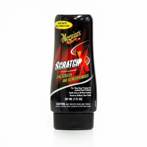

Blueadventures Posted January 31 Posted January 31 (edited) 7 minutes ago, Red said: Jesus wept, the guy was just talking about some discolouration that might not have even been noticable untill the stickers were removed Agree, talk about making a mountain out of a mole hill. A test fine polish cut would be all and some different shades would still exist. Do it on boat hulls all the time. The old rego numbers show due to the gel coat having been shaded by the numbers. Attached is what I posted that I use. Edited January 31 by Blueadventures 1 1 1
skippydiesel Posted January 31 Posted January 31 1 hour ago, Blueadventures said: Agree, talk about making a mountain out of a mole hill. A test fine polish cut would be all and some different shades would still exist. Do it on boat hulls all the time. The old rego numbers show due to the gel coat having been shaded by the numbers. Attached is what I posted that I use. This (& its ilk) are the perfect product, bit like an addictive drug, the more you use, the more you need to use it If you must use an abrasive, I strongly recomend extreme moderation😈
