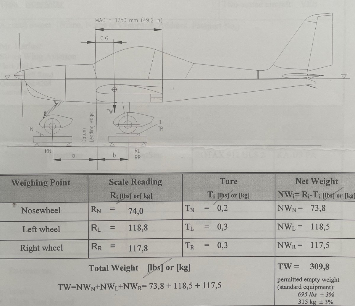

Moneybox Posted February 9 Posted February 9 The Datum is the leading edge of the wing. The fuel tank arm is 920mm and the baggage is 1270mm (in line with the wing trailing edge) and is just big enough for that pair of electric scooters that we're going to need to make it from the airport into town 🤣 The fuel tank is wedged in between the seats and the luggage space.

Moneybox Posted February 9 Posted February 9 (edited) On 09/02/2025 at 4:34 AM, 440032 said: I see some odd things. 74kg/L fuel. I think there is much lighter fuel available. "Empty plane" ARM is what? What is the datum point for this plane? I would have been expecting to see an ARM measurement from datum to nosewheel, and a weight, and an ARM measurement from datum to main wheels, and a weight. Expand HaHa, yes a typo. Grams if you like or 0.74kg. As stated the datum is the leading edge of the wing. I've entered ARM measurements from that point rearward. The positioning of the wheels is only relevant when calculating the CG of the empty plane. I don't think it has anything to do with my loading of Crew, Fuel and Baggage. Edited February 9 by Moneybox

djpacro Posted February 9 Posted February 9 On 09/02/2025 at 4:30 AM, Moneybox said: The Datum is the leading edge of the wing. The fuel tank arm is 920mm and the baggage is 1270mm (in line with the wing trailing edge) and is just big enough for that pair of electric scooters that we're going to need to make it from the airport into town 🤣 Expand Which model of the Sportstar? The POH for the Sportstar Max that I grabbed from online is different. It has fuel arm of 26.75 in (679 mm) and baggage arm of 43.65 in (1083 mm) assuming my arithmetic is correct! Crew moment arm is also different from your spreadsheet - 545 vs 500 mm. Suggestion: to check your spreadsheet use the example given in the POH. And ignore those who say use different datums etc, just follow the POH and the TCDS. 1 1
Blueadventures Posted February 9 Posted February 9 On 09/02/2025 at 6:28 AM, djpacro said: Which model of the Sportstar? The POH for the Sportstar Max that I grabbed from online is different. It has fuel arm of 26.75 in (679 mm) and baggage arm of 43.65 in (1083 mm) assuming my arithmetic is correct! Crew moment arm is also different from your spreadsheet - 545 vs 500 mm. Suggestion: to check your spreadsheet use the example given in the POH. And ignore those who say use different datums etc, just follow the POH and the TCDS. Expand Also does the log and other paper work contain its original or a recent w&b; if not try RAA maybe to get a copy if they can provide it. Some paperwork is only available to the first owner sometimes.
Moneybox Posted February 9 Posted February 9 On 09/02/2025 at 6:28 AM, djpacro said: Which model of the Sportstar? The POH for the Sportstar Max that I grabbed from online is different. It has fuel arm of 26.75 in (679 mm) and baggage arm of 43.65 in (1083 mm) assuming my arithmetic is correct! Crew moment arm is also different from your spreadsheet - 545 vs 500 mm. Suggestion: to check your spreadsheet use the example given in the POH. And ignore those who say use different datums etc, just follow the POH and the TCDS. Expand Thank you. Mine is an early model, 2004 with a single tank in the fuselage. The later planes have wing tanks that alter the CG amongst other things. I have been confused by the documents sent by Evektor. I've had to request original documents for the plane as most have gone missing. I have documents dated the same with the correct rego number and serial number but some are in metric and some imperial. Unfortunately I paid to have the Aircraft Operating Instructions printed and wire bound in A5 but the data is incorrect. I'll have to go again. Those instructions are dated 2006, with dual wing tanks and incorrect W&B for my model. Reviving an old plane comes with its challenges.

djpacro Posted February 9 Posted February 9 On 09/02/2025 at 7:14 AM, Moneybox said: Thank you. Mine is an early model, 2004 with a single tank in the fuselage. ..... Reviving an old plane comes with its challenges. Expand I've been through that. I found an appropriate POH and Maintenance Manual - the latter has the moment arms same as you stated. Your spreadsheet seems fine to me. My wife and I total about 150 kg and she would want to take more luggage than the 15 kg max of the Sportstar. Lucky, we have a different type. Quote It looks like there's room to expand on the fuel or luggage if I get the balance right? Expand Max baggage is 15 kg and max fuel is 65 litres regardless of balance. 1

440032 Posted February 9 Posted February 9 On 09/02/2025 at 4:49 AM, Moneybox said: HaHa, yes a typo. Grams if you like or 0.74kg. As stated the datum is the leading edge of the wing. I've entered ARM measurements from that point rearward. The positioning of the wheels is only relevant when calculating the CG of the empty plane. I don't think it has anything to do with my loading of Crew, Fuel and Baggage. Expand That excel chart you sent makes no sense to me. (the "empty plane" bit) I've done a similar chart for my own plane and seen many others, I understand what you are aiming to end up with, a good usable chart. I think it is now time for you to seek help from a professional WCO _ Weight Control Officer - an industry person accredited by CASA to do this stuff. Loading is not a thing to guessing or relying on advice from experts on some forum on the internet. Some will be correct, some will not. 1 1
Moneybox Posted February 10 Posted February 10 On 09/02/2025 at 10:08 PM, 440032 said: That excel chart you sent makes no sense to me. (the "empty plane" bit) I've done a similar chart for my own plane and seen many others, I understand what you are aiming to end up with, a good usable chart. I think it is now time for you to seek help from a professional WCO _ Weight Control Officer - an industry person accredited by CASA to do this stuff. Loading is not a thing to guessing or relying on advice from experts on some forum on the internet. Some will be correct, some will not. Expand It might look confusing as the results don't end up as a reference on a chart. They didn't supply a chart in this operators manual but use a % of Mean Aerodynamic Chord (MAC) as the load limits. I've got my head around it now and I'm happy with the results however I'm sure my trainer will set me straight when I get back there.
