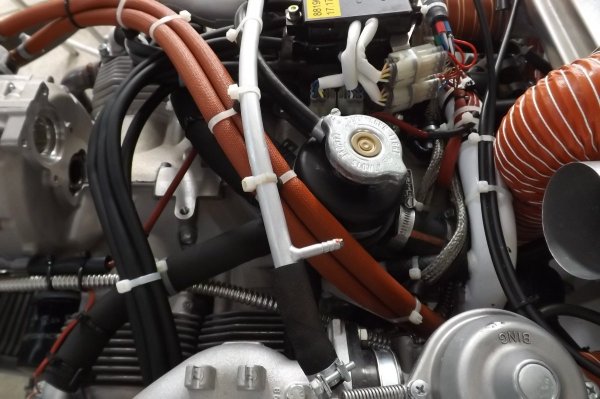

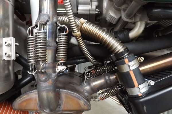

IBob Posted February 13 Posted February 13 (edited) bobcharl, the flexible SS radiator 'hoses' work fine. My kit was despatched Dec 2014 with them ,and so far as I know they are still supplying them: if there was a problem I'm pretty sure we would have heard by now. To avoid chafing, it's not difficult to secure them with cable ties, threaded through a short 'bead of regular hose to space them from the securing point. And they have the advantage that you can work quite a tight bend into them without flattening or collapse, as regular hose does when bent tightly. So makes for a very neat compact installation. You still need regular hose and hoseclips to make the junction at the ends. Edited February 13 by IBob 1

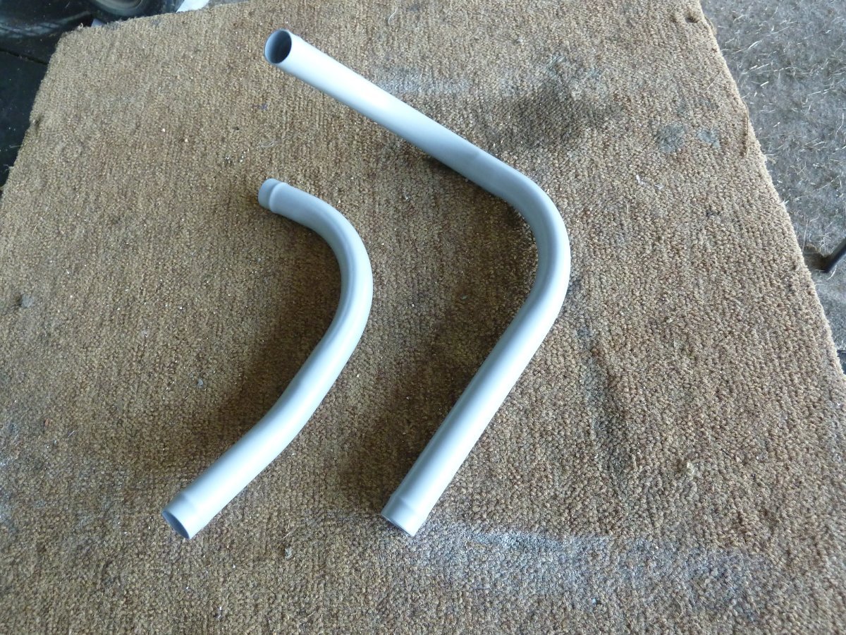

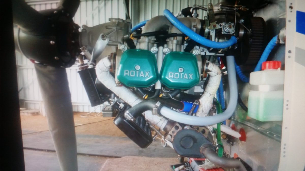

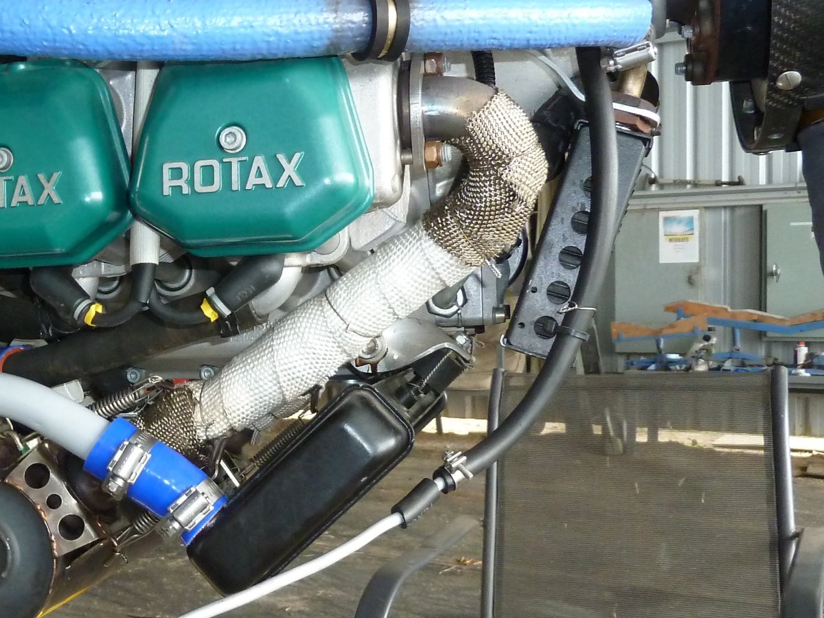

Blueadventures Posted February 13 Posted February 13 (edited) These are the silicone hose and alloy pipes on my 912ULS coolant setup. (Note the image of port side of engine is an old one and shows the black rubber hose, its changed to blue silicone years back and I'll get an up to date image.) The alloy coolant pipes are great and from Flylight Airsports in UK ; they are great and reduce the long lengths of hose that some people use. (The exhaust wrap is a mix of white and gold colour tape.) Edited February 13 by Blueadventures 3
skippydiesel Posted February 13 Posted February 13 I see worrying matters in the above photos (Blue & IBob). The corrugated oil & coolant lines & the alloy coolant pipes require at least two additional joins /pipe, compared with a single "rubber" hose - this introduces unnecessary potential failure points. The use of "plastic" filters within the engine bay is strongly advised against. The use of pleated "paper" filters is also strongly advised against.
IBob Posted February 14 Posted February 14 Skippy 1. Unnecessary potential failure points. I agree that at first sight 'rubber' termination of metal hoses could seem, in principal, messy and over-complicated. I guess that should be weighed against the benefits in practise.....and whether these additional points do actually fail. In practise I feel the metal pipe does a good job of making the required shapes in the Savannah engine bay. And I'm comfortable with those terminations. 2 & 3. Spot on. As noted above, another member here just pointed out that those filters are no longer acceptable. I have thanked him.......and now you......and will sort that out. 1

bobcharl Posted Wednesday at 10:32 AM Author Posted Wednesday at 10:32 AM Thankyou everyone for your thoughts on this matter. Did like blues solid pipes, but have some doubt re cowling clearance on the port side, and don't really want to wait for a delivery from the UK, so have decided to go with the SS corrugated tubing from ICP. Acknowledge the fact that they create a couple of extra joins on each side, but don't see that as a huge issue. Have only been able to source positive comments on these, and in the absence of any negative comments think that this is a reasonable decision. Thanks again, Bob. 3
