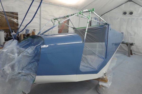

IBob Posted 16 hours ago Posted 16 hours ago I bought a car parking tent and erected it in the workshop. It was early spring, so heating was required. At one end of the tent I had two bathroom extractors venting to the outside. At the other end I cut a hole to take a 2.3Kw electric radiator...one of those cheap ones on little wheels. So with the fans on, air was drawn into the tent via the radiator fins. This gave steady gentle air movement that didn't kick up the dust. In the 'booth' I had a cheap wall thermometer. With aircraft part/s in place, I would switch on radiator and fans, then wait until the temperature stabilised at an appropriate level: as I recall, I would suit up and start mixing once I had about 23'C. The painting itself is pretty quick, I think I turned off the radiator before picking up the gun, as there would be plenty of residual heat in the radiator. This worked well for me. As mentioned by others, you need lots of light. This may not be essential for skilled painters, but I found the only way I could see what actual finish I was getting was to move my head so as to get direct lighting reflections off the surface. With just a few points of light you can't do this. I had lighting all down one side of the tent, that worked okay if I ran round the other side of the job. In a perfect world I would have had lighting down both sides. And if you look at professional high quality spray booths, the walls and ceiling are solid banks of lighting. (As an aside to that, if you get a 'dry' spot or area (too much air or gun held too far away) you can sometimes remedy it by loading up quickly with thinners and applying a light overspray of that. But you do have to be quick to spot it, before the paint hardens.......which requires that good lighting.) So, yes, lighting: you can't have too much. As a complete amateur (I once applied a coat of paint in an orange-peel finish to a Fiat Bambina, 40years ago, and that was it) I figured I would need all the help I could get. So I spent some time making supports to hold the wings tilted up towards me, as that was the easiest angle to be working the gun. And I rotisseried the fuselage with a suspension rope round the engine mount, which allowed me to paint it in four stages. Initially I had too much air at the gun, and had to clean back one complete wing underside and start again. I bought an air gauge to go on the gun, as the gun pressure is not the same as the compressor when you are spraying. Once I got that sorted out, and with careful focus on gun distance and speed, it went quite well. I did the colour last, and found it much easier to see how that was going on than with the white. 4 1 1

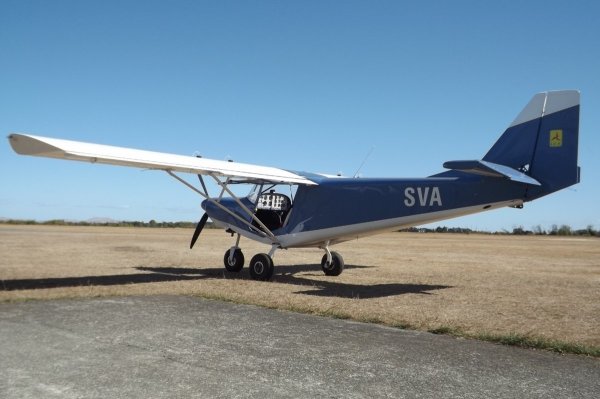

IBob Posted 14 hours ago Posted 14 hours ago In my opinion, some kit builds are badly let down by poor choice of colour and layout. Which is kinda sad, given the care and the hours that go into a build. It took me a long time to settle on what I wanted, and I spent hours over the final months looking at online pics of this aircraft before deciding on the layout. The online stuff is gold when it comes to seeing how a layout actually looks from different angles. Then I had trouble finding the colour: I knew I wanted blue, in the end I got a friend to help go through the housepaint colour cards at the hardware store, then I got the colour mixed. The layout is very traditional Savannah. I stuck with that as I think the white underside makes the aircraft look less heavy in the belly. And it's simple as it just follows the overlap in the skins. For the white tip of the vertical stabiliser, that looks right if it matches the angle of the forward strake. And another builder suggested that the registration looks best if applied fairly far back.......so I did that. Also it's on straight (and surprising how many aren't). What I didn't do was fiddle with colours and layouts on paper. First, you never actually see the aircraft in the side elevation often used for that. And second what may look good on paper can't be relied on to look good in real life. 1 2
skippydiesel Posted 14 hours ago Posted 14 hours ago Well done IBob - lots of initiative. I would suggest that the: two bathroom extractor fans ae insufficient - the principal is correct, just need to move more air. heater you used could easily be an ignition source - its use close to a potentially explosive atmosphere is very risky My paint booth was a wooden frame completely wrapped (including floor) in builders plastic sheet, (edge sealed with packing tape). Top/walls had an extra layer of bubble wrap for insulation. One end wall skin was about 1/4 air-conditioning filter (bubble wrap drop down sheet to keep warm air in when not spraying) The opposite end, double doors (to facilitate large component entry) with a ducted cheap industrial pedestal fan extracting air, in the left door, the other my entry/exit. About midway I had an old reverse cycle air conditioner mounted at ground level (warm air rises) with the thermostat set to deliver a constant 25C about half way up the structure (used cheap digital thermometers with Max/Min temp recording). The filter end of the structure had my paint preparation bench. I wet down the floor before spraying as an additional dust suppressant. An old rotatable engine stand was modified to hold the wing root end, of each wing , the tip supported by tie down point, either from roof or floor stand - this allowed the wing to be rotated about its long axis. I had no mains electricity so used a 7 kva generator for power and my compressor was/is a Honda powered unit. Will try & find some photos.😈 1

IBob Posted 10 hours ago Posted 10 hours ago (edited) Skippy, two bathroom extractors moved the right amount of air. They were 6", not the little 4" jobs. I think because they vented directly out through the (wooden) wall of my workshop. The owner who very kindly lent them had less luck, probably because he had them running out of his hangar through long spiral wound ducts. And as noted, I turned off the heater before loading the gun. It sounds like you built the Rolls Royce. My setup was a lot less sophisticated......but (more by luck than good judgement) it did work well here at the time. Edited 10 hours ago by IBob
