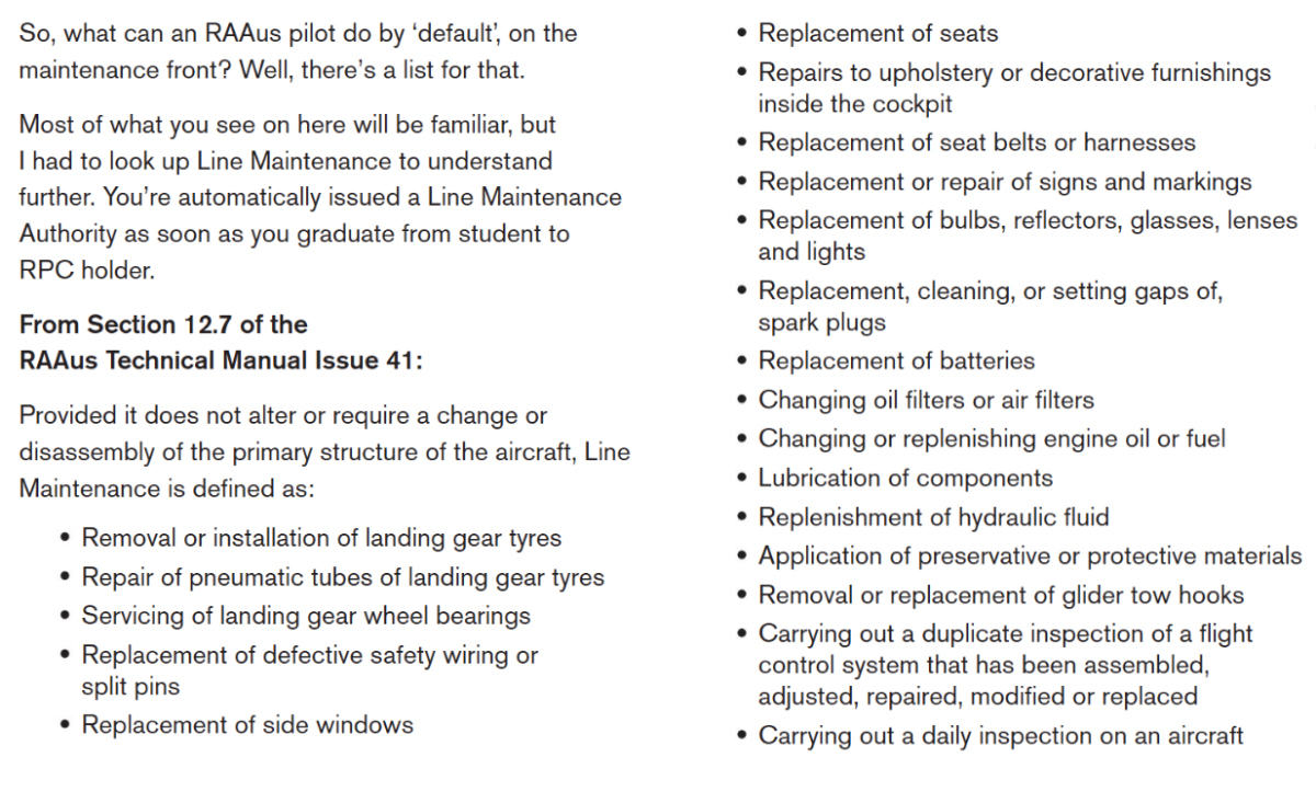

Blueadventures Posted yesterday at 05:11 AM Posted yesterday at 05:11 AM 19 minutes ago, Moneybox said: I did have one very experienced aviator tell me you can do anything you like to unregistered aircraft however it could influence the possibility of registering it later on. A useful reference to maintenance is on page 91 of the Sport Pilot issue 103. I keep a copy in my maintenance folder saves a lot of time-wasting arguments with knowitalls. 1 1

Moneybox Posted yesterday at 05:56 AM Posted yesterday at 05:56 AM 44 minutes ago, Blueadventures said: A useful reference to maintenance is on page 91 of the Sport Pilot issue 103. I keep a copy in my maintenance folder saves a lot of time-wasting arguments with knowitalls. That's an interesting article. Who needs an L1? 1 1 1

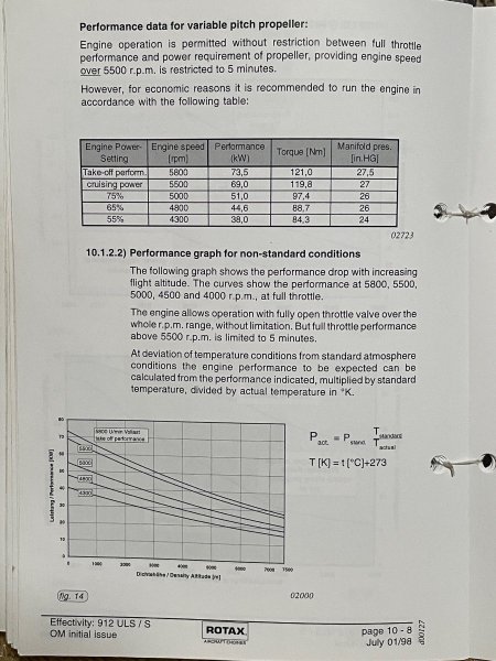

Red Posted yesterday at 07:40 AM Posted yesterday at 07:40 AM 6 hours ago, skippydiesel said: Sorry, I disagree. Rotax have a recommended STATIC (tied down/aircraft not moving) engine speed of 5200 rpm @ WOT. As you have an In -Flight - Adjustable (IFA) prop I would suggest that you set your system (prop pitch and in cockpit selector) to Fine /Take-Off mode, and re do your test. Adjust pitch and or in cockpit selector to achieve something close to 5200 rpm @ WOT/Static. 5200 rpm Static will likly give you a Take-Off & Climb-Out engine speed of around 5800 rpm. This is the Rotax max admissible rpm, for 5 minutes and will give you best performance/safety, in this phase of operation. Ideally, when your feel safe to do so, you can change your prop to Climb mode - at WOT this should be limited, by pitch setting, to 5500 rpm (continuous). Lower rpm can be achieved (minimum 5200) by reducing throttle and or increasing attitude. Over several test runs you will determine best airspeed/climb if not already specified in POH (RAA have a comprehensive test document (pdf) that may assist you) Again when you elect to change your prop to Cruise mode - your rpm will be that which you have set the system for (Max 5500 rpm) - most will go for better economy and have a rpm in the 5000-5500 rpm range (all at WOT). As PIC you will likly not Cruise very much at WOT, choosing a lower more economical engine power setting, however engine speeds should stay within the 5000-5550 rpm range. To optimise your prop settings for your airframe, record INFLIGHT Mode, Engine Speed, Air Speed, Altitude (or density altitude) & fuel flow (if no fuel flow indicator, average fuel consumed) - make adjustments and repeat until satisfied. Aircraft load, density altitude, wind speed/direction, runway surface conditions will all impact on performance.😈 Listen to Skippy here. Set max at 5200 tied down and prop full fine, if you set 5800 tied down as you stated then full fine in flight will allow an overspeed 1
skippydiesel Posted yesterday at 07:41 AM Posted yesterday at 07:41 AM 1 hour ago, Moneybox said: That's an interesting article. Who needs an L1? Interesting! Pretty comprehensive list with a couple of oddities; "Change oil filter or air filter". Why not both? "Replenishment of hydraulic fluid." Why not replacement as well? 😈
