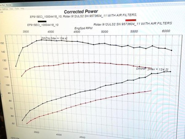

skippydiesel Posted 14 hours ago Posted 14 hours ago 4 hours ago, pmccarthy said: Ok here’s a related question to the above. In my Vixxen I have taken to flying about at 4000 rpm and looking at the details below when I go for a jolly. This gives me 60 to 70 knots , vs 27 knot stall speed. I don’t think the engine is overstressed, fuel consumption is way down. Of course, cross country is 5200 to 5500 rpm, but I am doing much more slow flying at present. Am I risking damage to the engine? In general the greatest load/demand on your engine is from start of Ground Run to top of Climb Out. The ideal rpm setting to address this demand, will be one that is past peak torque (in round figures - minimum 5200 RPM for Rotax 9's). Torque is a measure of the engines ability to do work, usually illustrated as a curve (see below). If your engine is operating ahead of peak torque, any reduction in rpm caused by additional load, will be accommodated by an increase in torque & no additional stress on the engine. Few pilots can maintain a constant load on their engine, in other than perfectly smooth flying conditions, so fluctuations in load are the norm. Operating at or below peak torque is likly to place unnecessary stress on your engine and will reduce aircraft performance when the inevitable increase in load occurs. Rotax recomend that its 9 series engined be operated in the range of 5200-5800 rpm for TO (minimum 5200 rpm). "In my Vixxen I have taken to flying about at 4000 rpm and looking at the details below when I go for a jolly" I would call this "loitering" - Your engine speed is perfectly acceptable in this flight condition, as long as a altitude can be easily maintained and you put "power on" to climb. "This gives me 60 to 70 knots , vs 27 knot stall speed" Engine setting , in this case, has little to do with stall speed other than you need to be aware that you have reduced your margin of safety above stall. "Am I risking damage to the engine?" No! I would council extra vigilance not to attempt to climb(load the engine) your aircraft while loitering.😈 1
