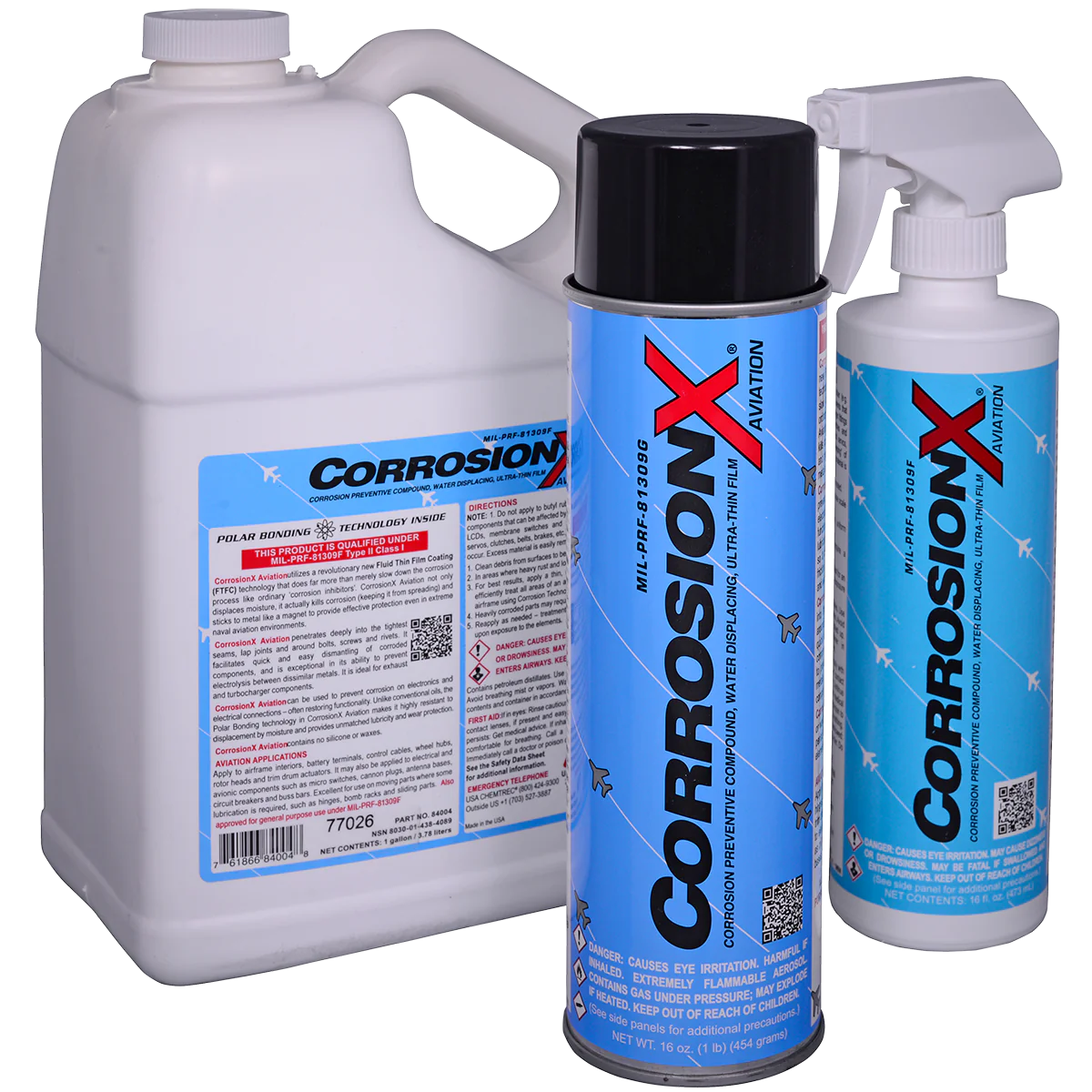

Blueadventures Posted yesterday at 11:17 AM Posted yesterday at 11:17 AM (edited) Have a look at 'Corrosion X' under their aviation uses. ACF50 is another to checkout. Edited yesterday at 11:19 AM by Blueadventures

Blueadventures Posted 18 minutes ago Posted 18 minutes ago (edited) On 22/03/2025 at 7:53 PM, rhtrudder said: Would there be any benefit of spraying inox inside the wings and fus to help with any corrosion, aluminum aircraft Inox = No /don't. Maybe buy a suitable product from an aircraft maintenance shop down your way that maintains seaplanes or aircraft kept near the coast. If going to Avalon talk to say SAAA, or the Sea Plane group or aircraft maintenance people they will know the uses and benefits of products like ACF50, Corrosion X and other products. Let us know what you find out. Edited 12 minutes ago by Blueadventures
