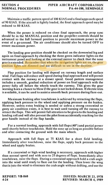

red750 Posted yesterday at 04:00 AM Author Posted yesterday at 04:00 AM There was a trick with the Arrow that my instructor pulled on me. If certain switches were on, (can't rmember which, it was over 40 years ago), the three greens would dim so they looked like they were not on. Maybe that was his problem. 1
Bosi72 Posted 23 hours ago Posted 23 hours ago 8 hours ago, red750 said: There was a trick with the Arrow that my instructor pulled on me. If certain switches were on, (can't rmember which, it was over 40 years ago), the three greens would dim so they looked like they were not on. Maybe that was his problem. It is Nav lights. Same is with Seminole. 3
