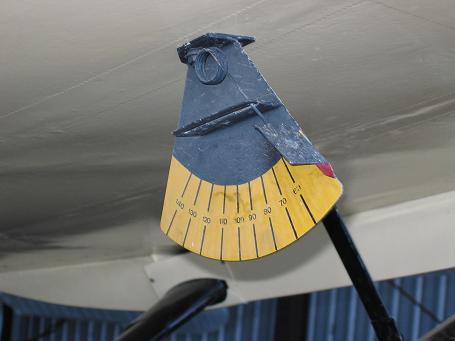

Guest Ken deVos Posted August 24, 2006 Posted August 24, 2006 I have also noticed the uneven fuel usageand will admit, would have to put it down to unbalanced flight - a bad habit I'm still working on, but a lot easier in the J160. However, I fully agree with Pete who wrote: "No electrics - no float or mechanical device that can go wrong. If you can see fuel, you got fuel, end of story". For those complaining about the difficulty of reading the fuel gauge..... Imagine if we still had to read one of these on finals. Ken deVos
