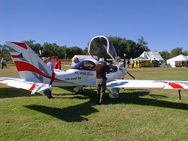

Guest Fred Bear Posted May 26, 2006 Posted May 26, 2006 Gregg says; "The Sting Carbon is VERY attractive. I'm a little sus about the massive bubble canopy without bracing. How strong is it?" To an extent this is a non event for 2 reasons. The sting has a very large and high tail surface. In the event of an aircraft rollover (say on the beach or onto a ditch or whatver) the tail MIGHT hold up the rear of the aircraft thus safely keeping the pilots head and upper body away from impact. No doubt the canopy would smash in a rollover. Safety couldn't be guaranteed in a rollover as if the crash impact forces are great enough, the tail would smash off anyways. Second is the rear of the Sting canopy - you'll notice the white strip behind the pilots / passengers head? This is crabon fibre re-inforced as part of the airframe. If you rolled over this part would protect your head. It's requried for the certification process anyway. You'd be hard pressed to find a certified aircraft that didn't have rollover protection, even in a low-wing design. Some uncertified aircraft such as the Corby Starlet unfortunately offer no roll-over protection, so before as you laugh as the Corby pilot who taxii's by with a George Jettson crash-hat on, no doubt he is very clever and protecting his noggen! I've looked long and hard at the Sting on many occasions and can't fault it. The design, build quality, features and performance is exceptional and hard to beat. It's been around for a few years now (debut in Narromine 2002), so there are others out there looking a little more sexy now days, but it's been around and has proven the test of time with quite a few very satisfied owners in OZ. Definitely worth a closer look. If you're after speed, the retract model offers cruise up to 150 knots. The only real step up from that in terms of performance is an RV in the GA market.
