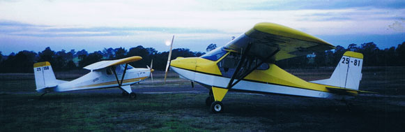

Looks to me like you need a LightWing, the two strokes are cheaper to buy and easier to fly, but the four stroke is more economical and a bit faster.
Built like the proverbial and a spacious cabin (compared to some).
Don't let being a taildragger put you off, but if you must, you can get a training wheel (tricycle) version for a bit more.

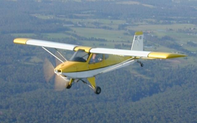

MATE is a lightwing the plane in the post you just made the picture as they look good and stable what about range how far do these planes fly on a tank of juice

The Lightwing is a good stable flyer capable of teaching you all the things you need to know without biting you if you screw up a bit.
They will generally take a fair bit of abuse both in the air and on the ground, will have to be seriously provoked before ending up in a groundloop, and often escape unscathed.
As for range, tank sizes can vary from earlier production models to later ones, and fuel consumption will vary depending on engine and prop used as well as how it is flown.
All aircraft are a compromise depending on what you want to do with it.
Many just look at the all out speed available, compare it to the price offered and do a dollars per mile calculation, but if you are going to go cross country you should also consider how comfortable the plane is.
I'd rather do two and a half hours in a comfortable plane instead of only two hours in a 10 kt faster, but cramped plane. (It's nice to be able to still walk after a long trip!!)
how far do these planes fly on a tank of juice?
The club I flew with had two LightWings, the 582 model (two stroke) only had 38 litres usable and wouldn't quite make it to Narromine.
The other Lightwing had a 912 (four stroke) and nearly 60 litres usable, and could almost fly Narromine and return non-stop.
These aircraft were primarily used for training and had props set more towards climb than cruise, thus better circuits, but slower cruise.
A good all round plane.
Arthur.
