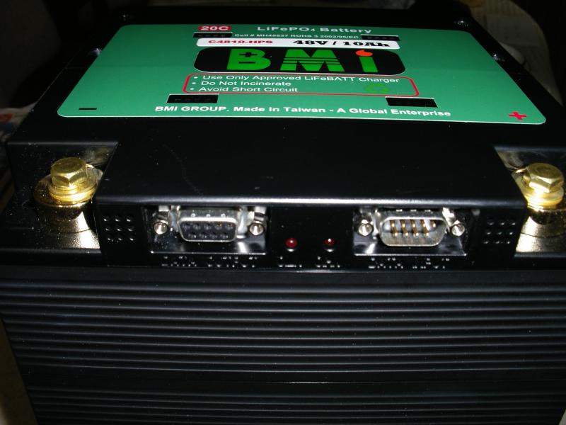

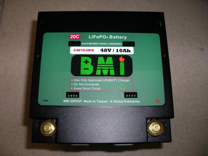

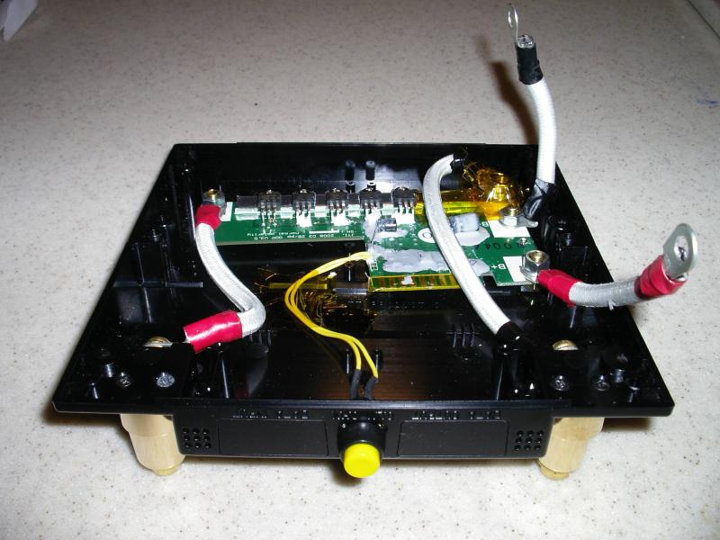

Guest Andys@coffs Posted August 4, 2008 Posted August 4, 2008 ......It should further be noted that these batteries are a very specialised product and are not just a plain battery made of cells connected together internally since each battery incorporates complex monitoring and control electronics which is known as a BMS (Battery Management System). It is for this reason that these batteries will not be available through your average battery shop since specialised knowledge is required to specify a suitable battery for any given application....... Armin. Looking at the photos you provided there appears to be just the standard anode / cathode connection. Is this BMS fully internal or is there a need for additional or changed support circuitry? Also, while it appears from the commentary you provided that the jabiru guys are interested did they comment on the change to CoG that would likely occur as a result of the change in weight? If I end up having to put ballest up front to address the change in CoG then nothing real may have been achieved (from an overall weight saving perspective) Andy P.S thanks for joining and providing info, though I'd suggest that the likelyhood of getting any of these into an aircraft without someone talking through the issues is about zip. we are a conservative bunch and as someone in another forum post pointed out the rotax 912/4 series uses an electric fuel pump. No battery = no pump equals going down....
Guest lithbattboss Posted August 4, 2008 Posted August 4, 2008 Hi Geoff, The BMS manages inter cell balance and activates the "yellow button" reserve capacity function which is built into the battery so that in the event of a piece of electrical equipment being left switched on accidently in an aircraft, boat or car the battery will completely shut down at 11.4 volts. By pressing the yellow button the reserve capacity is activated which provides enough power for about another ten engine starts. The end of charge voltage (whereby the battery will achieve a full charge) is 14.6 volts but slight overcharge of up to around 15 volts will not affect performance since the cells are relatively tolerant to overcharge conditions for short periods. To give you an example of weight, four cells are used in series to make a 12 volt battery. Each cell weighs 360gms so the total cell weight for a 12 volt battery is only 1.44kg. The total battery weight is approximately 2.3kg and this additional weight is made up of the BMS electronics, internal wiring, gold plated battery terminals and aluminuim and plastic battery case. The plastic used in these battery cases is a special plastic called Xytel which is manufactured by DuPont and has been chosen for its flame retardent qualities. All battery terminals are gold plated for long term corrosion resistance since these same batteries are also used for marine/boating applications where they are subject to salt water corrosion. Attached is a photo of the BMS board which is fitted into the top section of the battery and fits on top of the cylindrical high power 40138F1 LiFeP04 battery cells which are connected together with copper bus bars. Each internal cell has M6 threaded terminals so if several years down the track a cell were to become faulty the battery can be returned to the service workshop and a replacement cell fitted and the battery can go back into service. I am yet to hear of any instance where a cell has failed in any battery worldwide and the cells have been tested to over 8000 cycles by the US Department of Energy Laboratories. Attached in the second photo is a bare 40138F1 cell showing the threaed battery terminals at either end. This 10Ah cell is rated at 3.3V and has a peak output current of over 200amps.
Guest lithbattboss Posted August 4, 2008 Posted August 4, 2008 Andy, the BMS is all built into the battery so it is just a matter of direct replacement with a lead acid battery. Regarding the issue of the Rotax electric fuel pump. I believe the LiFePO4 battery is considerably safer and more reliable than any lead acid battery. Quick comparison- Lead acid battery = antiquated, heavy and inefficient battery technology invented over 100 years ago which contains corrosive sulphuric acid and toxic heavy metals like lead. Lithium Iron Phosphate (LiFePO4 battery) = latest battery technology invented at the University of Texas in the early 1990's and developed for use by the US military as a super lightweight, highly reliable power source. Solid construction cells which can't fail in the same way as fragile lead plates eventually do due to vibration. I will leave it to you to decide which battery you believe is the better choice!;) Andy, the Jabiru guys didn't mention anything to me about CofG issues. The one thing they did mention doesn't relate to aircraft in Australia but for their aircraft sales for the european market. They mentioned that they are very close to the weight limit for certification in certain european countries so where ever they can save on weight and keep the total aircraft weight down even by a few hundred grams here and there is of great advantage to them for the european aircraft market. After all the battery can easily be moved to another location to adjust for change in CofG. Much easier solution than an aircraft which simply can't be certified/has difficulty being certified because of its weight.

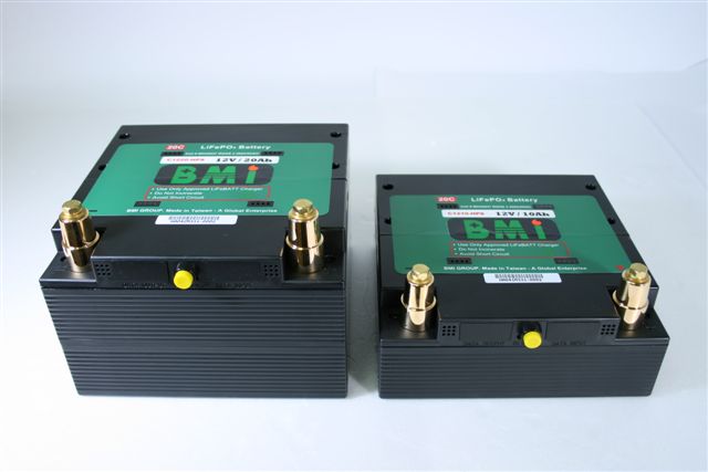

Guest lithbattboss Posted August 5, 2008 Posted August 5, 2008 Of course there is nothing stopping you from using the next battery size up if you want more power but bear in mind the next size up not only has double the cranking power of the smaller battery but is also close to twice the price. This is the 20Ah size and weighs in at 4.2kg This size battery is used for most family size six cylinder cars and is the battery size I installed in my own car. It will easily start a 3000cc petrol motor. The batteries perform much better at cold temperatures than lead acid batteries right down to below zero degrees. Lead acid batteries often eventually fail because the cell plates are made of lead so are quite fragile and can fail due to metal fatigue caused by vibration. The individual LiFePO4 cells are completely solid and therefore are not fragile like the plates in a lead acid battery. This translates to greater long term reliability.

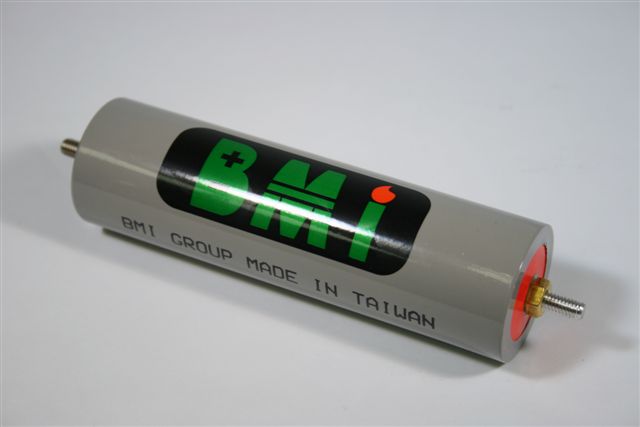

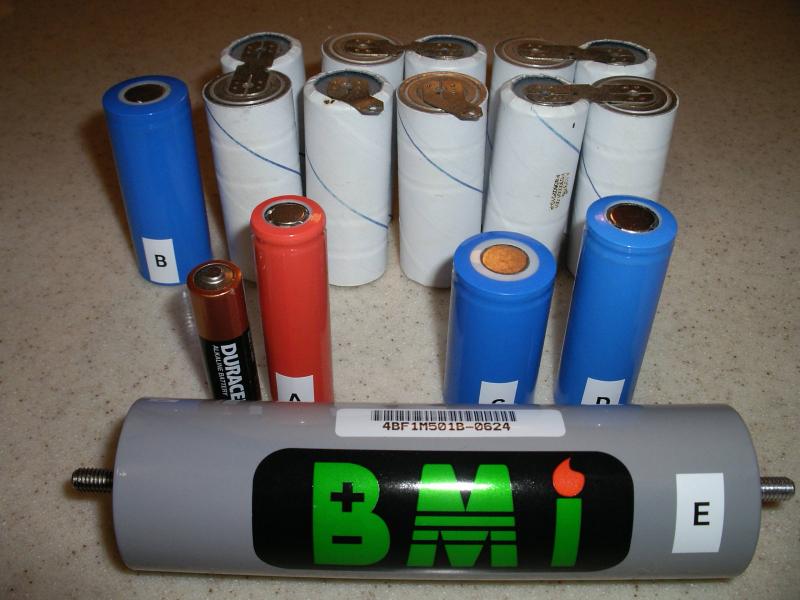

Guest lithbattboss Posted August 6, 2008 Posted August 6, 2008 Yes it is awesome Pete and yes you can believe it! I am extremely familiar with the cells used in the battery pack to start the bike in the u-tube video and have been using them for some time now. The SB1210C battery which will soon be available from the Clearprop Shop has even greater/longer cranking capacity than the battery shown in the video. The actual cells used in the batteries shown in the video are commonly used to make lithium ion cordless power tool batteries which are built by one of the major power tool manufacturers. The actual cells used in these packs are shown in the photo and are the white cells at the back next to the cell marked "B". The cells used in the construction of the aircraft starting battery (which yes, you can buy here:big_grin:) is the huge cell at the front of the photo with the threaded terminals marked "E". The smaller power tool cells have a capacity of 2.3Ah while the huge cell is rated at 10Ah. The smaller cell (used in the bike video) has a rated continous discharge current of 70amps while the larger cell has a rated continous discharge current of 120amps. Incidently the engineers at the Jabiru factory told me that their engine starter motor draws 80 amps while cranking. Since the smallest battery I provided them with can supply 120amps continously I considered the SB1210C battery to be adequate in size and capacity to satisfy Jabiru's requirements.

Guest lithbattboss Posted August 7, 2008 Posted August 7, 2008 The dimensions of the SB1210-C (12V10Ah) fuel saving engine start battery are 182x182x71mm. The battery weighs approximately 2.3kg. It comes with gold plated terminals for superior long term corrosion resistance and the case is made from DuPont Xytel plastic which is used for its flame retardent properties. I am discussing the pricing for forum members with Ian at the moment and we are trying the have the price of the batteries bought through the Clear Prop shop to be considerably cheaper than the recommended retail price. I hope we can have the price available in the next few days. I hope that helps.
