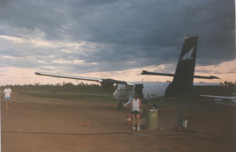

Guest High Plains Drifter Posted July 12, 2008 Posted July 12, 2008 How did u arrange the earthing? Large screw driver banged into ground, with a jumper lead to the drum - and aircraft. ... and I'm not saying that is the best way to do it. I think your on the right track by looking very closely at aircraft refueling.
Guest ozzie Posted July 13, 2008 Posted July 13, 2008 When you refuel from a drum. Place drum upright and let it settle for a period of time. undo lge stopper and put some water detecting paste onto the end of the spear and insert into drum. remove and check colour. tilt drum and place timber chock under drum. so lge hole is highest. earth drum to A/C and to groundpoint. make sure earth clamps are on BARE not painted metal. destatic yourself by touching a/c, not drum. reinsert pump spear and refill aircraft. leave the few lts on lower side of drum in the drum. (or your car) if any crap or water is in the drum it will stay here. do not use drums that have been stored upright in the open especially if they have water sitting on the top. expanding and contraction of the drum WILL introduce the water into the fuel. observe the use by dates. carry your own fresh water detect paste. drums stored on the ground in open should be laying on timber with the bung ends higher and horizontal. show good airmanship. when refueling is complete make sure you put the empty drum where it cannot be blown away by propwash and strong winds. i once chased someone elses empty drum across the hardstand at mangalore diving on it about 10ft from a Westwind Jet. (whew). Oh and save your back. get help to toss the drum. and observe the "distances from" in the regs and refueling guides. you never know who is watching ready to dob you in for your ignorence. Ozzie

Yenn Posted July 14, 2008 Posted July 14, 2008 Best not to have the big bung at the top side of a tilted drum. That puts the small bung at the bottom, where it can suck in water. Have them both level and the low point at 90 degrees. I have been using this method for 5 years, Gladstone airport allow me to fill Avgas drums, they have to be present to open the wide gate, but I can fill any other cans using a swipe card after opening the man gate myself.
Guest ozzie Posted July 14, 2008 Posted July 14, 2008 Ian if you were referring to my above post i will clarify. if not pls ignore. when you are pumping your fuel tilt the drum. pump side high. leave a couple of lts in the drum. any water and crap will stay in the drum. I never lay a drum down and tilt it. i lay them on two lengths of 6x6in treated pine with the bungs horizontal. I have never had a spark jump from the nozzel. i also touch the nozzel on the airframe before putting into the tank. in my kit i have a canvas mat about a foot sq. it has a hole in the center for the fuel opening. it is stiffened with 4 flat pieces of timber. simply unroll and lay over the tank opening remove cap and insert nozzel. not only will the mat help prevent a spark jump. it will save the paint from that clumbsy refueller. i pay paticular attention when those dry westerlies start around late August. I become the one that throws the spark. There is also the Mobile refueling guide. this is the way to do it. small portable elec pump with built in lge cartridge filters plugged into a 25,,000lt tanker. i treat fuel the same no matter what it is. remember. one flash an yous ash
