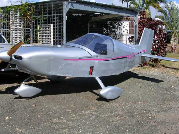

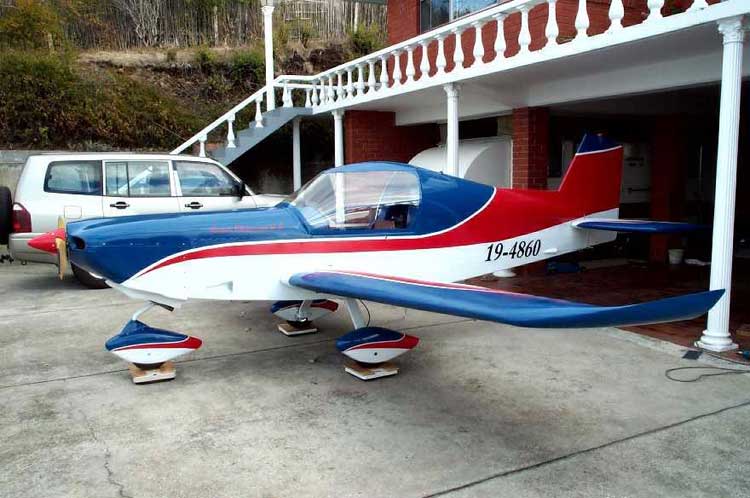

pylon500 Posted May 18, 2007 Posted May 18, 2007 As mentioned earlier, the Super Diamond and the Cheetah are fairly simple to build. They may not be completely idiot proof, but a little thought and an acceptance of what to expect for your money and a cheap, flyable aircraft can be built. At least two kits (see below) are ready for flight of the twelve or so kits sold so far. Arthur.
Guest kris Posted May 20, 2007 Posted May 20, 2007 Thanks guys for thr information and the pic's help a lot, have emailed garry for more information, hope to hear from him soon. If you have more pic's I would like to see them, once again thanks for your help Kris

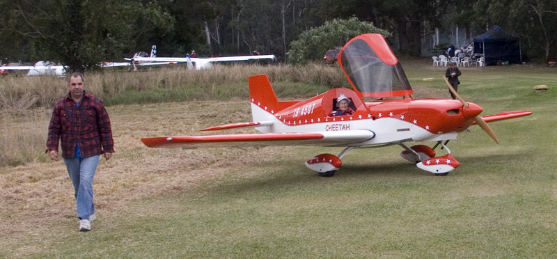

slartibartfast Posted July 1, 2007 Posted July 1, 2007 BigglesWorth - I'm going back to Taree to sort mine out this weekend. Soon there'll be 2 in this area. We'll have to introduce them to each other. Perhaps they'll breed. Here's Garry, the Cheetah, and Arthur's (Pylon500) mum in it at the RecFlying flyin. [ATTACH]2456[/ATTACH] Ross

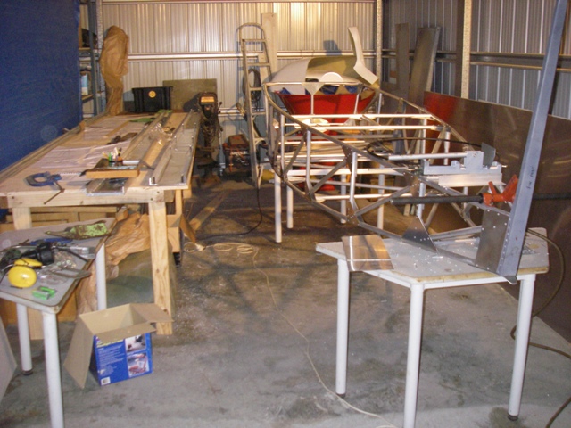

Bigglesworth Posted July 5, 2007 Posted July 5, 2007 I'd better hurry up, I have got the tube frame built and the spars almost. I haven't got a loan approved yet so I might get stuck without a motor :( How many rubber bands do you think I need? Considering that Garry's designs come from models, it might work I think I managed to attach a picture of how far I got.
