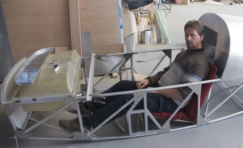

Attached is my boss and I in Garry's demonstrator at Natfly.
Used without permission of my boss, and he's probably going to read this.

The Sierra is going to have a slightly higher/larger canopy which will help with headroom, although Garry says that they have had 6'2 in the cheetah.Seating is in sports car fashion with very low seats and is comfortable if you like that sort of thing (I do). Elbow room is 42 inches, just keep away from large people and you will be fine.
Answered while composing mine. You can't have too much advice.

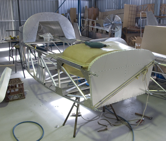

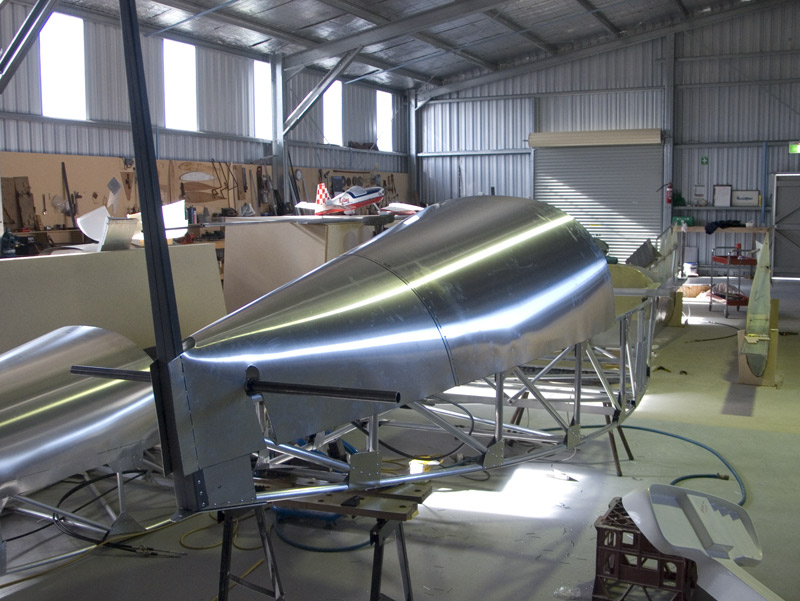

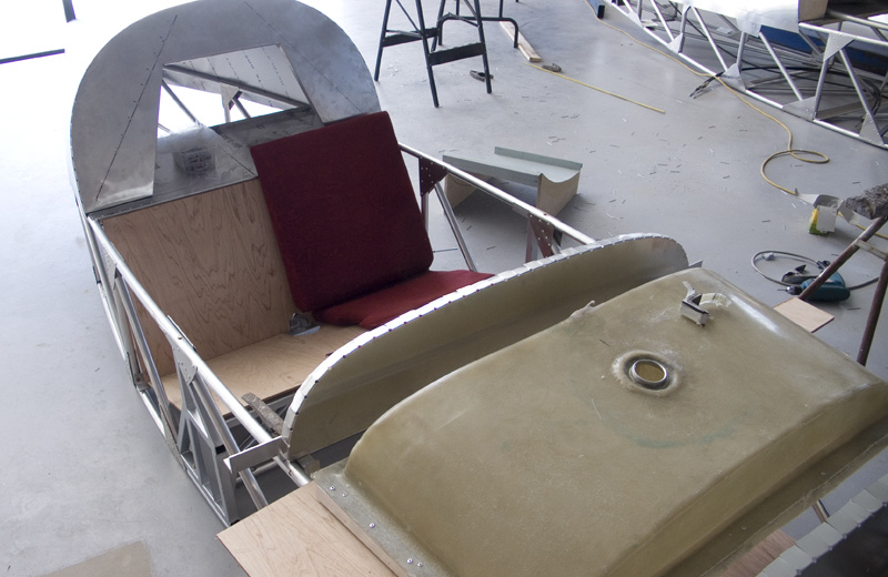

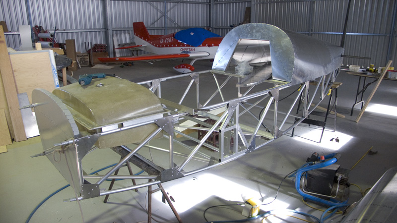

Here's some shots of where I'm at.
[ATTACH]3118.vB[/ATTACH][ATTACH]3119.vB[/ATTACH][ATTACH]3120.vB[/ATTACH][ATTACH]3123.vB[/ATTACH]
Fits like a glove. The seat will be from a mould and drops me another 2 inches. In fact that's the mould on the floor in shot 3 above.

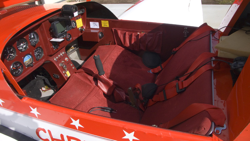

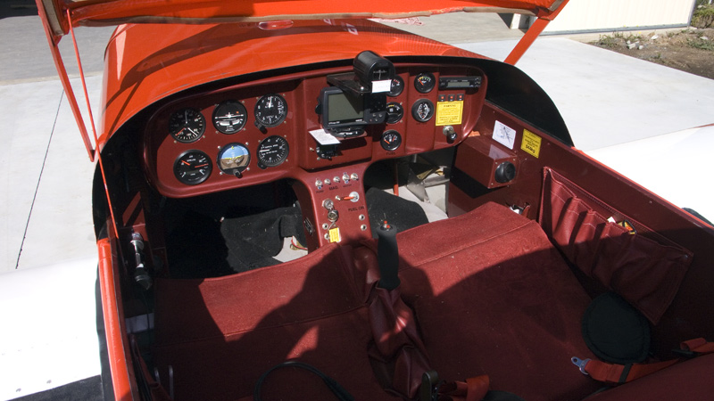

and Flyer40 - here's a couple of interior shots. Remember - it can be made higher and wider than this. Like mine.
[ATTACH]3121.vB[/ATTACH][ATTACH]3122.vB[/ATTACH]
Extras? Let's see. Powermate regulator, toe op differential disc brakes, Rota buckle 4 point harnesses, Naca vents, Jab cabin heat kit (else no chance of getting my wife up over the snow), cig lighter, MicroAir radio/icom, Odyssey battery, other bits and pieces.
