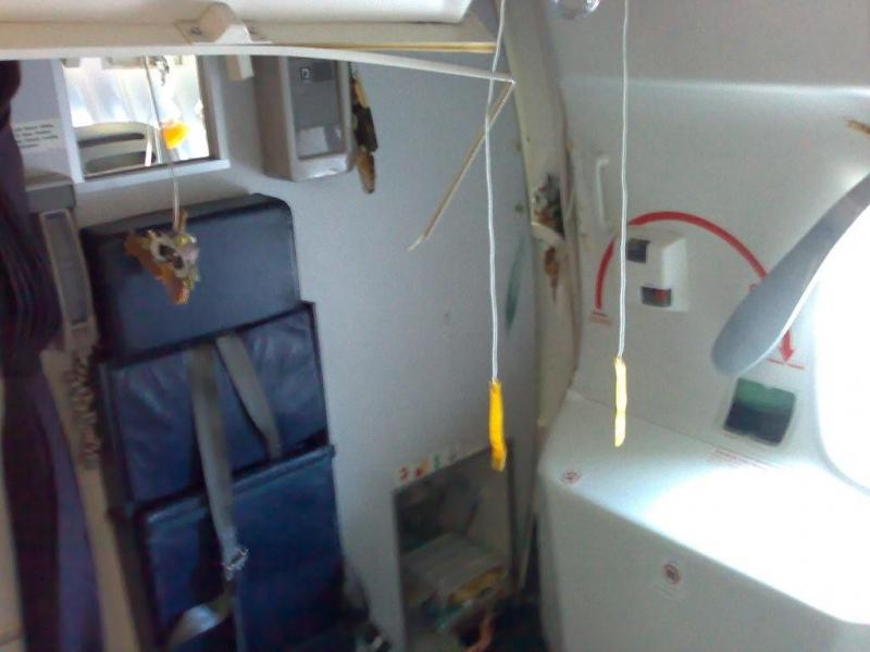

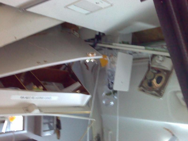

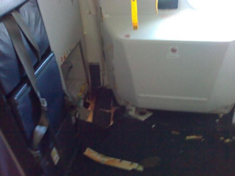

im still amazed at how the oxy bottle could blast its way into the cabin, hit the door handle up, bounce around a bit, and still find its way back down the hole in the floor and then outside the airframe. though its interesting to note, the crew portable oxy bottle is missing as well.
very lucky no one was injured with a heavy steel bottle flying around the area of row 26.

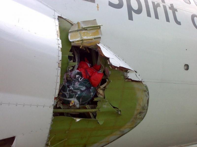

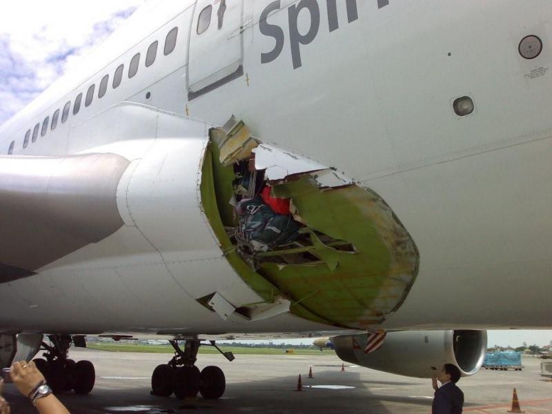

The whole report made sense until the last page...... so having made a hole in the floor, which the picture shows to be not much bigger than the diameter of the cylinder, the cylinder bashes the door, breaks, inverts biffs the roof, inverts again, falls down and neatly goes through the same hole that it made coming up...... If onlY i could be so lucky at lining up my lotto numbers........ Does this seem to be seriously stretching the co-incidences to anyone else.... Especially when you consider that in the sequence explained you have at least 3, possibly more pieces of cylinder, 2 of which were above the floor and none can be found......(well, actually the last drawing suggests that teh cylinder valve head was in the main cabin)
Not saying it couldn't happen just amazed at the likelihood of it occurring

It also struck me that if the initial failure was in the bottle valve then the bottle would be going down not up (every force has an equal....blah, blah). That seems to suggest that the bottom of the bottle failed first, or that something caused the bottle to rotate after the top failed.
The whole story of the perambulating, peregrinating bottle is causing me a little doubt.

If you look at the last few pages you'll see that indeed they are suggesting that the bottom of the bottle failed. Bottom bit exits throught the skin. bottole minus bottom goes through floor and hits door in such a way that the valve head breaks off while the cylinder is inverting.....and so on.

Hi all,

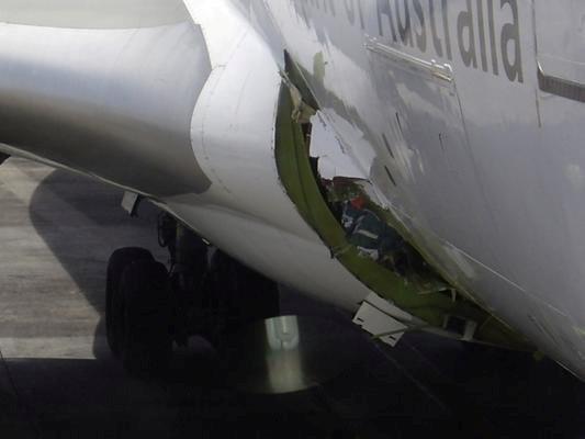

For your viewing:thumb_up:
Taken on the tarmac after the pax had disembarked
