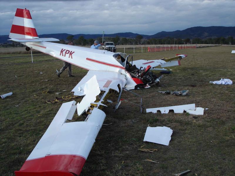

Guest TOSGcentral Posted September 2, 2008 Posted September 2, 2008 My appreciation for the kind sentiments expressed - greatly appreciated. But let us stay fixed on what it all (and this forum) means to all of us. So we will go a step further - this is what it actually was (after clean up). [ATTACH]6376.vB[/ATTACH] [ATTACH]6377.vB[/ATTACH] Now I have not quite finished - but for once we are going to settle, in real terms, what this forum is actually about! T,
Tony Posted September 3, 2008 Posted September 3, 2008 So sad. I just think, would not a pilot release the pressure on the rudder and ailerons in order to cancel the side-slip forward and follow up with elevator use to set a stabilized and required speed on short final......for some reason they could not get this right in time. I ask myself, were the rudder (or ailerons) unfortunatelly stucked in their quite extreme positions for a good side-slip but would not go back to neutral when required....., the pilots would not bother to move elevator up before clearing the side-slip. On the first photo the rudder is still right hard.
Guest TOSGcentral Posted September 3, 2008 Posted September 3, 2008 The rudder was quite free - that is just where I happened to have left it after inspecting the tail unit. You could move the rudder full travel with one finger. The elevator was jammed in the position given on the photo primarily because of the forward damage (the torque tube for example was folded virtually in half). However there was nothing to suggest the entire control circuit had been defective prior to impact. This was confirmed by a GFA airworthiness inspector who took a good look yesterday according to a telephone call that I received. The three control circuits on a Falke are simple, well designed and (other than the rudder which is cable driven) are entirely push rod linkages.

Guest TOSGcentral Posted September 3, 2008 Posted September 3, 2008 My apologies Airsick. I stuck that embargo on as an intended temporary measure as I had posted only two hours after the event. By then I knew I would be able to provide a fair bit of information which would then steer comment rather than chase up blind alleys. Unfortunately I did not remove the 'muzzle' - go for it as far as I am concerned - I will give what answers that I am able, as in fact I already have started doing so. Go for it if you wish. Here is another: Hi John. Good idea mate and on the right track. There was actually very little in the cockpit. The parcel shelf behind the crew had had a few items on it (which had been cleared by the decelleration into the cockpit) but nothing that could have caused a control jam that I could see. The largest object (some kind of aerosol thing) possibly could have but was totally undamaged which it would not have been if force had been applied to it. T.
Guest TOSGcentral Posted September 4, 2008 Posted September 4, 2008 A few more odds and ends for you plus the current state of what is happening. The latter will give some insight into what happens with these situations for readers who have not been previously involved. The engine was running at impact and would probably have been fully throttled back which is normal approach configuration. From the position of where the difficulty was presumably encountered the Falke was quite capable of gliding the full length of 12 and going out the other end. This is quite normal with motor gliders hence why they have spoilers or airbrakes. There was no report that any power increase was made nor would that be needed under the circumstances. If a power increase had been made there would not have been any significant engine effects to disturb the aircraft vis a vis the relatively small engine compared to a rather large aircraft (over 15 mtr wing span) The fuel tank was dipped, there was fuel in it, but again this has no significance as the aircraft could have been entirely dead stick at the time and the situation would still have been entirely normal operations. Some situation data: The local police stated yesterday that CASA were not interested and would be taking no action. That is normal these days in my experience – but we do still have to initially report to them and that is mandatory for any accident or incident. The police further stated that they were finding inspectors capable of inspecting the wreck as they were really not equipped to even though having responsibility for it. They opined that this would probably be GFA but if they could not get GFA then they would have to look elsewhere Search & Rescue (who originally sent me out) bowed out immediately I had given them my initial report of where the aircraft was, what it was and that full emergency assistance was on site– as they did not know other than it was ‘near Watts with an injured crew’. This is normal procedure and you then have to go to CASA itself. GFA did promptly respond and yesterday put an inspector on site. On an informal telephone conversation with GFA yesterday I was told that GFA had finished with the wreck and found no evidence of control malfunction. They considered that their part was now over and would be making their report accordingly. They invited me to do my own detailed examination (but let them know the results). That will not be possible until the wreck is released by the coroner or I am formally invited into the investigation (note that I am not speaking for GFA just recounting what was told to me). I expect that now the police will draw all the facts they have together and make an initial report to the coroner. The coroner will then decide if s/he can make a finding or will have to take to a court Inquest. Generally, the above will give you a current appraisal and I will report more (within the bounds of taste and legal ability to do so) if anything significant comes up. The situation is in fact moving quite rapidly and there is no indication of any of those involved that people are standing on their hands and will ‘get around to it’. When the dust has settled I will do an overview on a new thread as there are some things that this event has underlined that I feel should be the subject of open opinion.

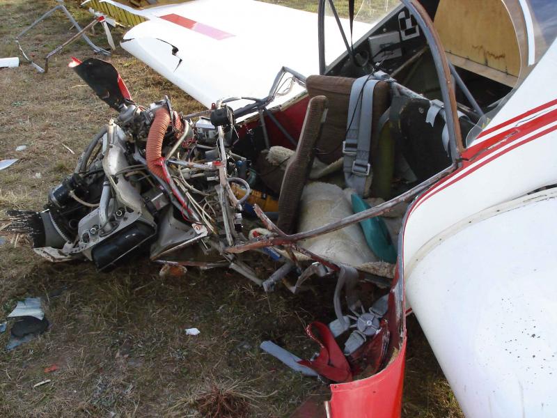

Downunder Posted September 4, 2008 Posted September 4, 2008 Hello Tony, In one picture, the seat belt is broken. Was this cut by the rescue team? Regards. R J Mitchell
Guest TOSGcentral Posted September 4, 2008 Posted September 4, 2008 Yes - all four of the straps were cut off the pilot to get him out . That is why the still assembled buckle is laying on the ground at the bottom of the picture because we could not get at it.
