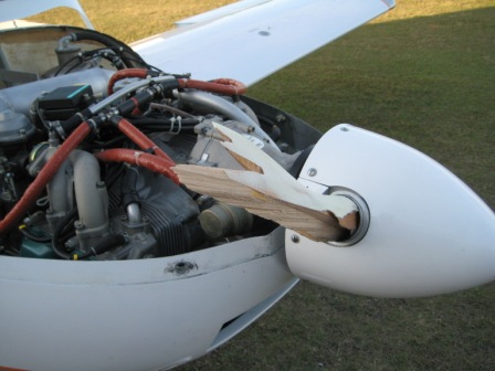

wags Posted September 1, 2008 Posted September 1, 2008 On Sunday 31st August a Czech Airworks "Sportcruiser" was conducting circuits at Gympie Airfield with the aircraft's new owner and an instructor onboard. Slight vibration was felt throughout the aircraft during initial climbout and x-wind legs of a circuit. The instructor reduced power somewhat but approx 30 secs later a very loud "explosion" occurred and the engine came to an abrupt stop. A short stub of one blade of the 2 blade Woodcomp inflight adjustable propeller was visible protruding over the cowling. The aircraft subsequently carried out an emergency landing back onto the airfield without further incident. The occupants suffered no injury other than to their nerves. The aircraft was virtually new (50 hrs or less?) and had not exhibited any previous propeller problems that I am aware of. What remains of the prop stub displays what looks like water seepage (or similar) has occurred between the wood laminations of the blade, but this fact will need to be confirmed by investigators. The engine has obviously "twisted" on its mounts with at least two mounts showing indications of significant distortion. The engine exhaust stub had moved approx 100 mm or more and impacted the nose wheel mount with sufficient force to dent the exhaust pipe itself. Both carbies of the Rotax 912 had disconnected themselves from the intake manifold and no doubt aided in stopping the engine before further damage occurred. The strength of the airframe no doubt contributed to a safe outcome for the occupants of the aircraft. The outcome of an investigation into this incident will be interesting to read as this would appear to be a catastrophic failure of what could be considered as a brand new propeller. It will almost certainly require replacement of everything from and including the firewall forward. I for one will take more than a precursory look at the blades of my prop during any preflight from now on looking for signs of any tell-tale hairline cracks or indications of delamination starting to occur, especially around the hub area.

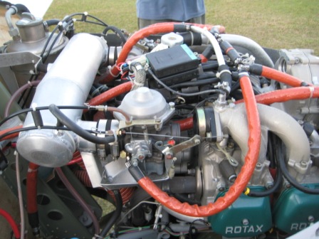

johnm Posted November 25, 2008 Posted November 25, 2008 photos I think there will be 2 photo's attached to this email One shows the broken blade One shows carbbies pulled from engine - by forces when blade broke This is not a reflection or comment about the 'aircraft and hardware' used in this thread - it just shows you what could happen up front
Guest Michael Coates Posted November 25, 2008 Posted November 25, 2008 Note Michael Coates has been banned from this site
Guest ozzie Posted November 25, 2008 Posted November 25, 2008 I won't mention that crappy looking plumbingthumb_down
johnm Posted November 25, 2008 Posted November 25, 2008 There was no plumbing installed in the aircraft - this option not installed (and I doubt whether available) I am told however, if there was such plumbing installed - it would of been put to great use
Guest becky1 Posted December 13, 2008 Posted December 13, 2008 Hi everyone, Just to set the record straight I was flying the aircraft when the propeller snapped on early downwind.In reference to Michael Coates comment about there being another lesson to be learned here by not pulling the aircraft around by the prop,this definately was not the case in this particular incident and perhaps if Michael had all the facts which are well known now to the investigating authorities,he may not of insinuated that this may have been a reason for the failure especially when the aircrew involved can read it on this forum The pieces of the propeller have all been found and proven to be faulty. The aircraft and prop had done a total of 96 hours and had been moved around the hanger with a towbar with extreme care,the aeroplane has never spent a night outside,it was always thoroughly preflighted and the lack of glue on the wooden section inside the carbon outer sheaths could not be seen,so no one had any idea there was about to be a failure. It was a frightening experience especially when it happened with no warning and such a violent bang and a jarring right through the whole aircraft. both my student who also owns the aircraft and I were very fortunate that the carbys did come off the engine which stopped it straight away as I doubt our reaction time could never have been quick enough to turn it off before further damage to the engine mounts and firewall which may have resulted into something far worse than a deadstick landing Jennifer
