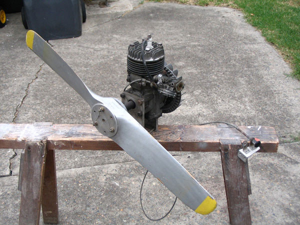

Guest ozzie Posted September 4, 2008 Posted September 4, 2008 on a good day i get 5.5hp and 35/40lb thrust at 5500rpm from 100cc pioneers

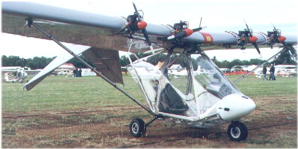

pylon500 Posted September 8, 2008 Posted September 8, 2008 Hey this all sounds like fun! :thumb_up: I have spoken to various people in the AUF, RAAus and sure enough, if you can keep it under 300kg, you can just about do anything. Hi Ozzie, yeah I flew Fernando's Lazair quad, a little scarey, but I'm fairly sure it was all quite legal. i_dunno I had even had thoughts of going sort of the same way using the Lazair style wing structure to build a scaled Me-323 Gigant using SIX Kirby or Mccullough two strokes (been keeping this quiet so no one would beat me, but I'll never have the time anyway...) The fun thing flying a multi like Fernado's was using the four Tiny-Taks to sync all the engines. ps, Freewheeling props DO cause drag. :ah_oh: C'mon BlueHawk, where's some piccies? :pics: Arthur.
vk3auu Posted September 9, 2008 Posted September 9, 2008 Yeah, that was the one at Narromine. That was where the photo was taken . David:juggle:
Guest ozzie Posted September 9, 2008 Posted September 9, 2008 Be nice to copy the pod and landing gear for mine. need the extra engines for the increased weight. 4 electrics would be nice and build the batteries into the pod Arthur, why did you find it a little scary? when you are using these Victa type engines make sure you knock all the fins off the flywheel if you are not using forced air cooling. you pick up a few extra hundred rpms. does anyone have the prop pitch dia for victas.? ozzie
pylon500 Posted September 9, 2008 Posted September 9, 2008 The scary bit was watching the wing skins wrinkling in turbulence, they may do it normally, I had just never noticed. I also weighed about 105 kg then as well :ah_oh: only about 90kg now, doctors orders! does anyone have the prop pitch dia for victas.? Don't know what size the reduction props were on the Scouts, the ones I made for my Kirby's (144cc) were 32"x12"s direct drive. They probably would have ended up around 32"x16" to be effective. Yeah, c'mon electrtics...:thumb_up: What, no gasps at my Gigant? :hittinghead: Arthur.

Bluehawktechnologies Posted September 10, 2008 Author Posted September 10, 2008 Hey this all sounds like fun! :thumb_up:I have spoken to various people in the AUF, RAAus and sure enough, if you can keep it under 300kg, you can just about do anything. Hi Ozzie, yeah I flew Fernando's Lazair quad, a little scarey, but I'm fairly sure it was all quite legal. i_dunno I had even had thoughts of going sort of the same way using the Lazair style wing structure to build a scaled Me-323 Gigant using SIX Kirby or Mccullough two strokes (been keeping this quiet so no one would beat me, but I'll never have the time anyway...) The fun thing flying a multi like Fernado's was using the four Tiny-Taks to sync all the engines. ps, Freewheeling props DO cause drag. :ah_oh: C'mon BlueHawk, where's some piccies? :pics: Arthur. Sorry for the slow response I have tested four of the Victa mower engines to see about thrust. It does not have enough rpm:sad: I am still looking at the other motors you guys talked of though and so far the performance is 100% better than the Victa. My engine mounts also seems to have issues (development of cracks have turned up after tests)It could be because of the stiff wings so now I have to inspect the wing internals for damage as well. The experiment continues.
