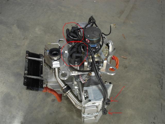

Tomo Posted October 17, 2008 Posted October 17, 2008 G'day Craig, I sure you will enjoy your first lesson tomorrow...:thumb_up: And I'm sure we all look forward to hearing how you go....!! You probably understand about the magneto's now from the other guys, but just to show you what they look like in real life, I came across a photo that I took of a Jabiru 2200 four cylinder engine.... I know you will be flying in a Tecnam, with a Rotax 912 in it no doubt, but it's still a 4 cylinder, and works in the same way..... The wiggly circles are around the magneto's or distributor's... and the two arrows show the two leads going to each cylinder... which there is two cylinders on each side... Cheers,

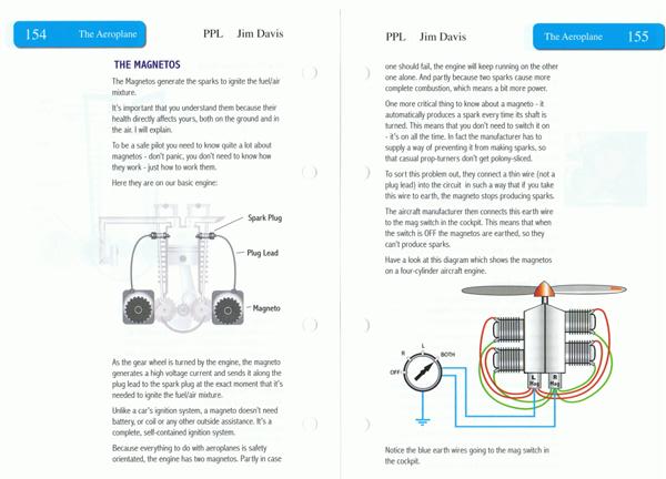

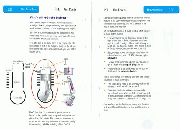

Tomo Posted October 17, 2008 Posted October 17, 2008 I just scanned some pages out of my Jim Davis book, I don't know how your book explains the magneto's, but this is pretty simple and easily understood version... well I reckon it is anyway...;) I don't know how it will turn out, you may have to print it out on a full page to be able to read the writing... anyway i will leave that up to you....:big_grin: Cheers...

Guest Cralis Posted October 17, 2008 Posted October 17, 2008 Thanks Tomo! Now I see! :) My instructor called me this evening confirming tomorrows lesson. I think he said that the Tecnam Echo doesn't have Magnetos!? Is that right? Or should I say ... Did I hear him correctly??
