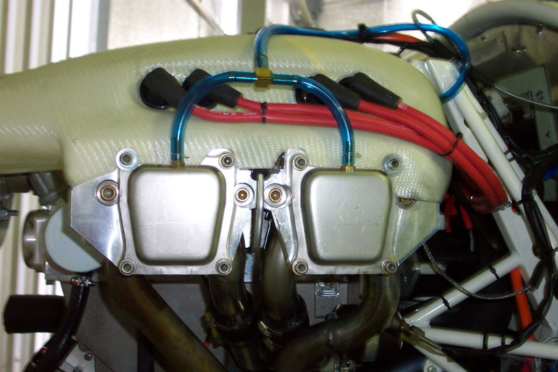

Guest micgrace Posted September 27, 2006 Posted September 27, 2006 Hi all What does those people who have an intimate knowledge of J2.2 engine think about the modification to the crankcase "vent" system? as in the latest AD See RAA mag for detail. I'm not of the opinion this was a good solution to the problem. ie negative pressure buildup in the rocker cover area. A far better solution should have been found than this. Micgrace :)
Guest Fred Bear Posted September 27, 2006 Posted September 27, 2006 I've spoken to them about it and spoken to people who have done the engine course. Finding the problem (that caused the oil to break down) took them ages and cost them one h*ell of a lot of money. It will definitely increase engine and oil longevity which can't be a bad thing. There is a much better explanation in the full AD which is located on the Jabiru website.
TechMan Posted September 29, 2006 Posted September 29, 2006 My 2c this time. Personally, drilling a hole into an engine which allows air to get in, will also allow 'other stuff' to get in. Even though it is only a tiny hole, if it is based at the bottom of the fins as depicted in the SB, surely either a) water can get in or b) the hole is going to be blocked up with dirt that it will have no use at all. Having said that, the SB works well on Jabiru aircraft installations. Having a Jab motor fitted to another type of aircraft will not guarantee the results as described in the SB. A very recent occurrence of this resulted in an aircraft losing oil through the vent holes , followed by smoke out of the engine bay on take off. The position of the breather tube did not make a difference. The picture below shows the modification to the engine that worked for him. This was discussed with Jabiru and they know of this case. Make your own mind up as to what the better 'solution' is. Chris The tube is plugged in to the back of the ram air ducts - filtered of course, and provides just enough pressure to relieve the vacuum. The holes that were drilled previously have been plugged up again.
