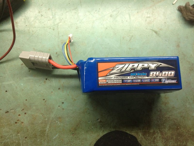

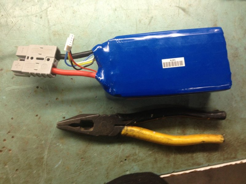

JabSP6 Posted April 23, 2013 Posted April 23, 2013 I did buy 2 packs and tested them out in parallel. This gave me a scare because the engine belted over so hard I worried about burning out the starter-motor.So now I am only using one pack and it still belts over. This makes the weight 1 kg plus the battery-box. The cranking voltage is 11 volts with the single lithium pack as opposed to 9 volts with the Odyssey. The lithium obviously has a lot less internal resistance. One of these packs would make a good booster setup if you have trouble starting on frosty mornings. Is that what a cpap is? ... Bruce Hi Bruce I am keen to talk to you more about the light weight battery option. I have sent you a PM Thanks Andrew (JabSP6)

Kyle Communications Posted April 29, 2013 Posted April 29, 2013 No Hank I didnt use the acid battery that came in the kit I use a sealed AGM style sports machine battery 18 amp hour I think it was...it has been fantastic The 8400 mah A123 battery it is for my CPAP machine to have in the tent with me. I am very happy with my 8.5kg battery now in the back of the Sav because she flys soooooo much better now. I got the 8400 ma battery from hobby king on friday so got it charged and setup for my Resmed auto set and I slept for 9 hrs on saturday night...long for me and my machine never missed a beat I wanted to see how long it would actually go until the CPAP stopped working and used it last night after I got home. It stopped 3 hrs into my sleep so it went for 12 hrs total use which I think is awesome. I will charge it from the battery in the Sav you do need a small special charger which I have anyway. The other side of this is I can also plug the 8400 ma battery direct into the anderson plug I have at the bottom of the plane where the old battery was for jumper starting the aircraft. The 8400 ma weighs only 1 kg so it has a lot of plusses for sure

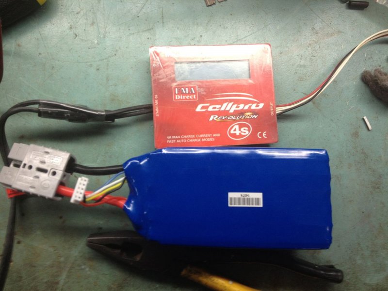

Bruce Tuncks Posted August 18, 2013 Author Posted August 18, 2013 It's 18 months now ( Feb 2012) since I first tried the LiFePO4 battery from Hobbyking and it's time for an update. Here's the story: After finding out that one of the 8400mah packs had ample cranking power, I went back to the Odyssey until I got a "Protection Circuit Module for 4 cells LiFePO4 pack" from All-Battery.com. You can Google this up. This was a bit of a disappointment when I got it because the by-pass current is only listed at 60ma, when I would have preferred a lot higher, say 200ma. Anyway, I hard-wired this in and operated with this setup for over a year with no problems. This is with the ordinary Jabiru regulator which apparently is a tractor spare part. It cranked over really well every time. The battery didn't explode or catch fire , but I have seen a story that an airliner had a fire and heard a rumor that a Colyaer may have had a fire. Then one day after about 15 months, I left the master on and when I came back next week the battery was dead and couldn't be revived. Since I bought 2 of these batteries, the second one is now in the plane. I'm planning to install a buzzer to help me avoid leaving the master on. To implement this I reckon I need to replace one of the mag switches from the existing 2 pole single throw to a 3 pole single-throw. The idea is for the buzzer to sound when the master is ON and that mag OFF. Yes I know it shouldn't be necessary and I know that a strobe which is always on when the master is on would work too. I don't want the weight of the strobe and I don't think they are effective in broad daylight. Maybe I'm the only person who leaves the master on once every 5 years or so. regards, Bruce 1

Bruce Tuncks Posted September 27, 2013 Author Posted September 27, 2013 thanks Thalass, I didn't know what those 787 batteries were. I'm still working with the Hobbyking LiFePO4 battery, But I've found out that the protection board I bought was wrong for the job. It needs to work as an individual cell charger. ( thanks, Mark) Here's my current plan: The max charge voltage for a LiFe PO4 is 3.6 volts. Now you can buy a 3.6 volt zener diode. So how about "shorting" the individual cells with a 3.6 volt zener? The idea is that below 3.6 volts, the charging is normal, but when 3.6 volts is exceeded , the charge current bypasses through the zener for that cell. Yes I know this is too easy and simple but why not? regards, Bruce hope the LiFe PO4 batteries are safe.
