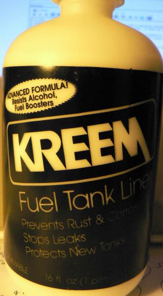

Ross Posted November 30, 2008 Posted November 30, 2008 Hi Bob Apparently Jabiru's original fibreglass tanks were lined with a sloshing material that was not proof against any fuel containing alcohols such as ethanol. It was OK for Avgas. Their newest tanks I am led to believe are sloshed with "Kreem" supplied in approximately half litre bottles at about $58 per bottle as of May 2008. Acetone is used as a thinner with this material to aid application. [ATTACH]6858.vB[/ATTACH][ATTACH]6859.vB[/ATTACH][ATTACH]6860.vB[/ATTACH] According to Dan Mulder at Jabiru "Kreem" is compatible with ethanol and all petroleum fuels.

geoffreywh Posted December 2, 2008 Posted December 2, 2008 In my motorcycle shop we often ran into tanks coated with "Kreeme" They did NOT always have a good result..The faults seen were peeling,bubbling and generally looking like crap, when it comes loose at the tank filler neck. (the kreeme) it can be easily peeled from the steel...In the end I contacted a W.A. epoxy manufacturer and they supplied a product that could be poured in warm and sloshed around. Perfect result. Long term too. .....BUT as always preparation was paramount !!!!!!! Was the Kreeme at fault or the acid etch?
