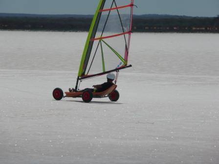

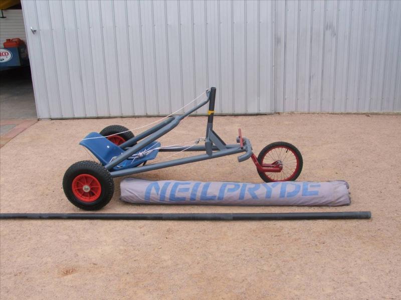

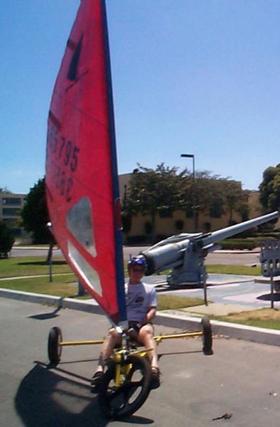

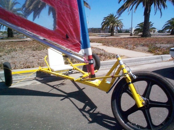

BLA82 Posted November 23, 2008 Posted November 23, 2008 Hi all, the xmas holidays are coming up and I have set myself a new project-making a landsailer. I have used a friends one numerous times but his is a factory built blokart. I would love one but just cand seem to come to terms with the $3000 pricetag for what I see as a wheelbarrow with a windsurfer sail. lol Has anyone on here either owned one or still own one and any hints? I found the below pics on the net of other homemade ones

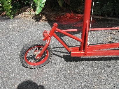

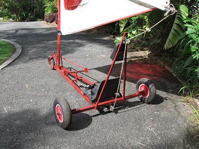

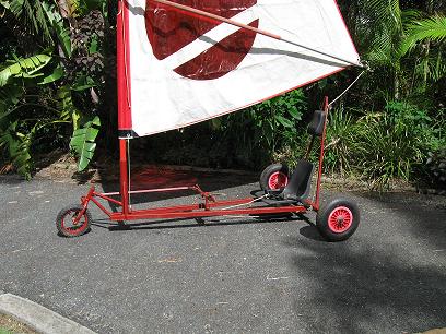

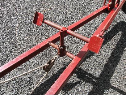

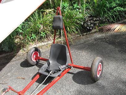

Guest Evan Cameron Posted December 4, 2008 Posted December 4, 2008 Give me a couple of days to sort out some photos and construction details. As I'm fairly new to this computer buisiness,I'll have to get my son to help. I can say that the two we built cost next to nothing, the back wheels are wheel barrow type ( new), the front wheels , forks and peddle steering etc are made out of a couple of $10 kids bikes from Vinnies, mast posts are exhaust tube,frames are box steel, seats are $2 plastic chairs from the Sallys and the masts and sails were picked up cheap from life line. I must say that I do have my own welder plus oxy /accetylene which certainly helped. My son got the plans off the net but they're not there any more.I'll draw up something with measurements and take lots of photos and get back.:thumb_up:

Guest Evan Cameron Posted December 7, 2008 Posted December 7, 2008 Hope these give you an idea.The overall length is 2.4 m, width is 1.5m. Let me know when you've got it up and running and if you find a good place to sail it.
