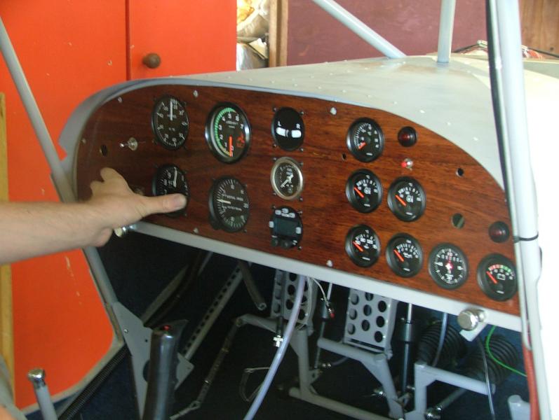

Have the dash panel painted early and do not fit the support under it until the dash is well and truly in. Make up the dash when you need a break from the airframe. It is good fun and it is nice to look at when your pals come around.
