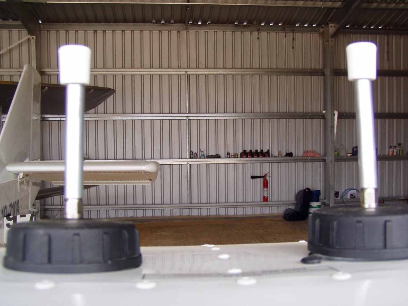

Ron Hoey Posted February 7, 2010 Author Posted February 7, 2010 Fuel breathers I know many of you are concerned about the fuel tank vents, as I was. My solution (about version 3) is in the attached photo. The idea I copied from the oldest plane I could find, a Gazelle. The fuel tank vents are a piece of aluminium tube the right size to fit over the supplied connector and the top is a plastic foot for a stool or something with a leg. Both from Bunnings. The top of the cap is separated from the top of the tube to allow air through, but, as a precaution, I also drilled a small hole in the leading edge of the tube underneath the cap. Both are riveted together at the back, which pushes the leading edge of the cap forward to catch the airflow. I think it will work OK. Blue skies all, Ron.
