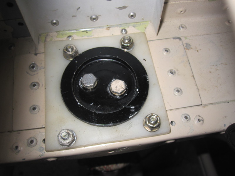

eightyknots Posted March 26, 2013 Author Posted March 26, 2013 Quote .... also made inspection windows for the wing strut attachments just to keep an eye on things inside ... Hi Geoff, I'm interested in this inspection window. Where exactly does this go? What needs keeping an eye on?? Do you have a picture of this mod???
skyfox1 Posted March 27, 2013 Posted March 27, 2013 Hi EK the window is at the wing strut attachment on the leading edge strut on the wing. This is the reason l have done it just to check it easy so hopefully this doesn't happen cheers Geoff. 1

skyfox1 Posted March 27, 2013 Posted March 27, 2013 Here is the link it was supposed to be on my last post didn't work. http://www.ilmailu.org/forum/index.php?action=dlattach;topic=500.0;id=362 1

Phillip King Posted March 29, 2013 Posted March 29, 2013 Hi Geoff After looking at the broken wing mounts on the sav.Your inspection holes are a good idea.I striped the paint of the engine mount and welded another top plate, one hole did not line up. I mounted the engine last night but it did not want to mount flush up against the aluminum mounts the rubber engine mounts are stoping it going all the way up, do you have spacers in between Cheers Phil
skyfox1 Posted March 30, 2013 Posted March 30, 2013 Hi Phil Not sure what part you mean, l have lord mounts between the chrome moly and the aluminium mount. Post a pic so l can check it out . Cheers Geoff.

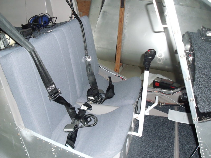

Phillip King Posted April 5, 2013 Posted April 5, 2013 Hi Geoff Some up update photos on the 701. Cheers Phil 1

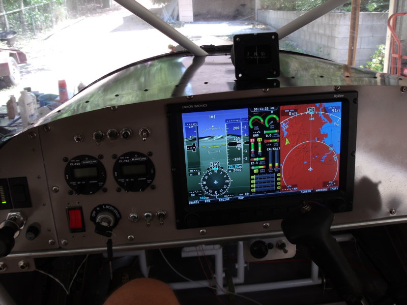

derekliston Posted April 10, 2013 Posted April 10, 2013 Finally got the SAAA MPC out of the way, might be able to get back to my aeroplane. Always other things to get in the way though. Wish it wouldn't rain so much and I wouldn't have to mow so often. 1
Phillip King Posted April 10, 2013 Posted April 10, 2013 Hi Derek Like the pics looks like you are doing a great job on the plane I like the way you have done the the cowl, did you fabricate the hole thing yourself? Cheers Phil

eightyknots Posted April 11, 2013 Author Posted April 11, 2013 Quote Dont know why some of the photos loaded twice? Looks like you've got a pretty flash dash, Derek!

derekliston Posted April 11, 2013 Posted April 11, 2013 Quote Hi DerekLike the pics looks like you are doing a great job on the plane I like the way you have done the the cowl, did you fabricate the hole thing yourself? Cheers Phil No, bought the nose bowls from Jabiru, made life a bit difficult, looks better in the photos but should be Ok by the time I finish it. Nose bowls are too wide for the firewall really so took alot of thought and a lot of effort to get it looking right. Still not happy with my cowl latches but they will have to do until I find something better.
