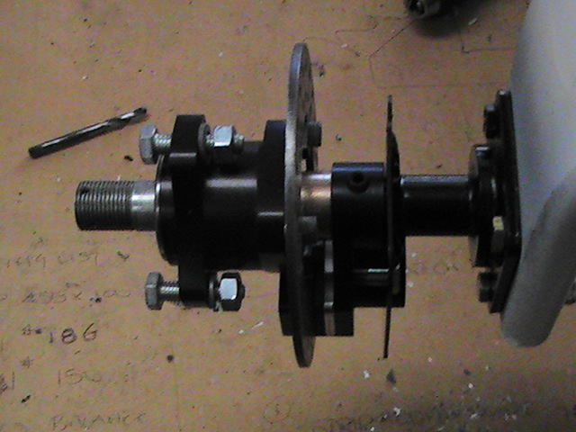

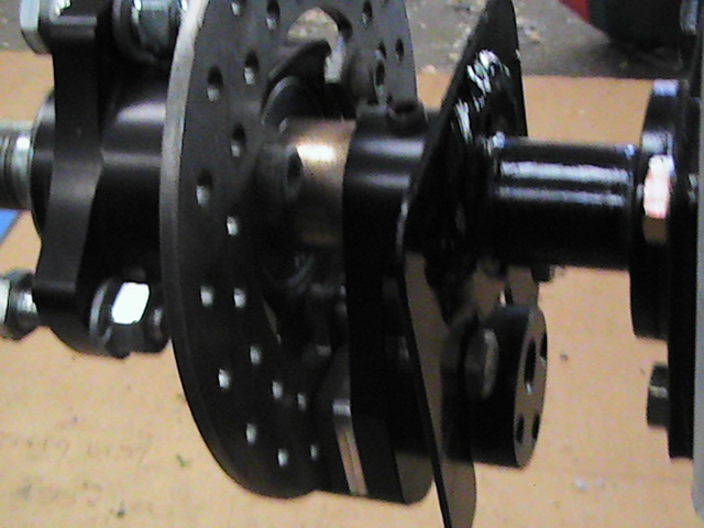

skyfox1 Posted August 13, 2013 Posted August 13, 2013 Hi Phil here the pics of the blackmax brake system l have fitted . cheers Geoff.

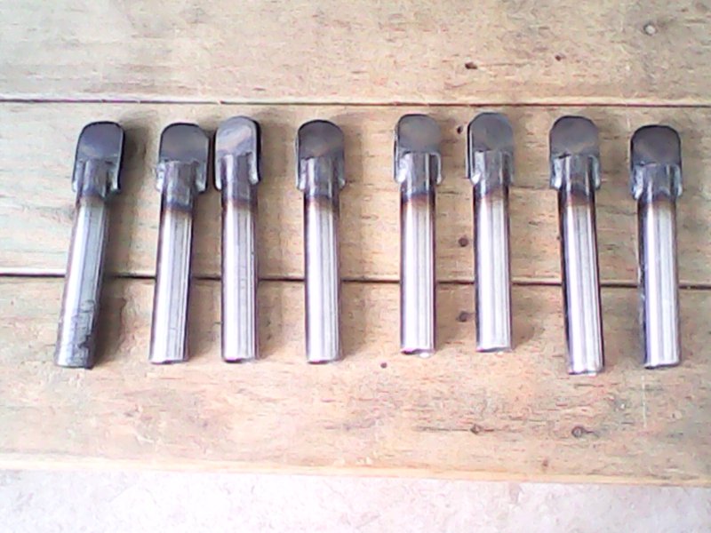

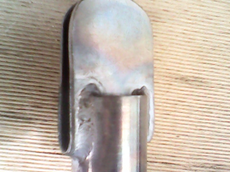

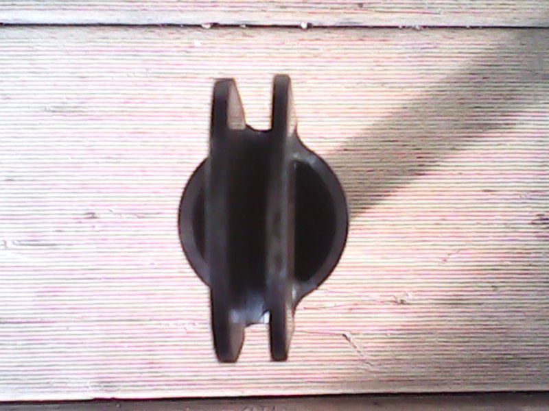

skyfox1 Posted September 27, 2013 Posted September 27, 2013 Hi Phil Here are the pics of the wing mounts that l have made they are going in to savannah wing struts . cheers Geoff.
rankamateur Posted September 28, 2013 Posted September 28, 2013 life keeps getting in the way!! Sure beats the other alternative hands down!
skyfox1 Posted September 28, 2013 Posted September 28, 2013 They are l bit of over kill but sooner have some thing it that area that is bullet proof .
Marty_d Posted September 28, 2013 Posted September 28, 2013 Hi PhilHere are the pics of the wing mounts that l have made they are going in to savannah[ATTACH]23673[/ATTACH] [ATTACH]23674[/ATTACH] [ATTACH]23675[/ATTACH] wing struts . cheers Geoff. Lovely work Geoff - those welds look very nice. I wish I could weld but I'd never trust it, so will be outsourcing all the welding work.
skyfox1 Posted September 28, 2013 Posted September 28, 2013 Hi Marty l can weld alright but I had a aircraft welder do the welds just to be sure they were perfect . he does a excellent job .. are you putting the standard struts on or aero foil type ,l got some second hand struts off a savannah trying get reduce some drag on the 701.. cheers Geoff.
Marty_d Posted September 28, 2013 Posted September 28, 2013 Hey Geoff, I bought all the round tube for the struts so will probably use them unless another set of Sav ones comes up. Had thought of adding bent 0.016" 6061-T6 front and rear to form an airfoil shape, but shying away from the idea of riveting to the strut in case it weakens it. How did you go with the size of the Sav ones, did you have to shorten / lengthen or are they identical? Cheers, Marty
skyfox1 Posted September 28, 2013 Posted September 28, 2013 Hi Marty l had to lengthen them that's why l have made the attachments longer for the extra length required . l wasn't keen in drilling holes in the tube to fit aero foil material because the are only 0.49 tube and it will weaken them . cheers Geoff ..

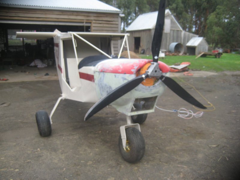

Phillip King Posted September 30, 2013 Posted September 30, 2013 Hi All Your wing mounts look great Geoff very nice welding job. I am waiting for the new bungee then i can start mounting the engine back on, all the bolts and spacers are drilled for safety wirer, throttle and choke cables made up, cowl nearly done,only need to make up a battery holder. Have cut and shaped new dash only need to cut holes for gages.What do you use to cut holes and what size and type of battery do what i need for the 582? cheers Phil
skyfox1 Posted September 30, 2013 Posted September 30, 2013 Hi Phil l have nearly done all my control cables l will send you my swag tool so you can do yours next week . Cheers Geoff
Phillip King Posted October 2, 2013 Posted October 2, 2013 Hi Geoff Thanks mate that will be good. got the new bungee today its to big so they are sending another one, Going to put the engine on today, waiting to here back from Bert flood regarding the oil eject, bit of sanding of the cowls. Blowing a gale down here got wet twice so home for the day.Cheers Phil
