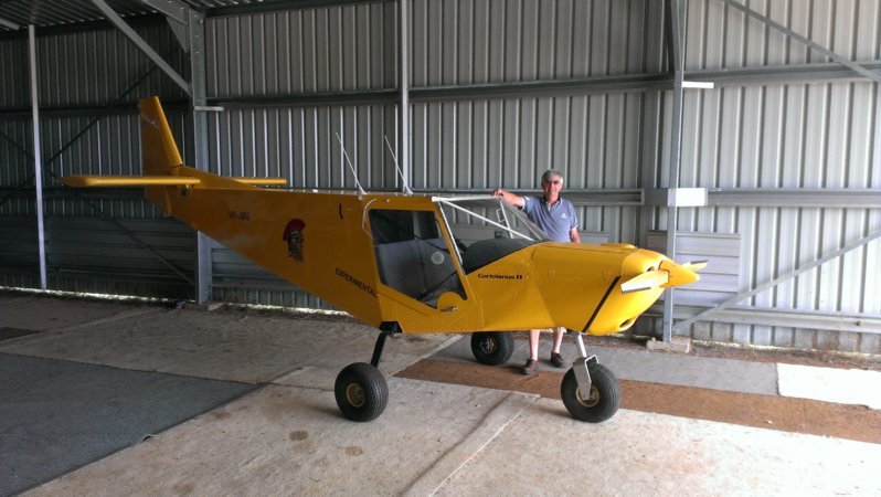

Guest Maj Millard Posted October 28, 2013 Posted October 28, 2013 Since I'm on the site here can anyone offer any advice . We have a new Zenith 701 in the area (ex-Kilcoy ), it has the slats removed, standard leading edge with VGs. The flap lever is placarded 'don't use ' !!.......it was flown up here so obviously it flys, but what's with the no use of the flaps..Is the VG installation offically approved for this model, are there any 'danger' areas we should be aware of with the no use of the flaps ??????,........ any info appreciated................Maj.....
eightyknots Posted October 28, 2013 Author Posted October 28, 2013 Since I'm on the site here can anyone offer any advice . We have a new Zenith 701 in the area (ex-Kilcoy ), it has the slats removed, standard leading edge with VGs. The flap lever is placarded 'don't use ' !!.......it was flown up here so obviously it flys, but what's with the no use of the flaps..Is the VG installation offically approved for this model, are there any 'danger' areas we should be aware of with the no use of the flaps ??????,........any info appreciated................Maj..... Was this Hans's Zenith? (it has a Savannah-style empennage, I think)
skyfox1 Posted October 28, 2013 Posted October 28, 2013 Hi Maj Mine had Vgs when l purchased it and the flaps were in use all the information on the Zenith web site that others have put Vgs on all still have flaps in use cant see any reason why they wouldn't be able to be used ,they prefer flaps on to get the stol effect ,l am putting the slats back on mine . cheers Geoff.
JG3 Posted October 28, 2013 Posted October 28, 2013 Since I'm on the site here can anyone offer any advice . We have a new Zenith 701 in the area (ex-Kilcoy ), it has the slats removed, standard leading edge with VGs. The flap lever is placarded 'don't use ' !!.......it was flown up here so obviously it flys, but what's with the no use of the flaps..Is the VG installation offically approved for this model, are there any 'danger' areas we should be aware of with the no use of the flaps ??????,........any info appreciated................Maj.....
JG3 Posted October 28, 2013 Posted October 28, 2013 That was Phil's 701. He flew it a lot, every Sunday for some years, around and around in circuit, many hundreds of nice landings. He didn't use flaps, and it flew really well just like that. It was an early model that had the provision for 30 degree flaps, which Zenith later deleted. With 30* you can get a flaperon stall and wing drop with a sudden aileron application. The 30* doesn't give all that much more STOL anyhow, so he didn't use flaps at all, and still did excellent STOL performance. JG
