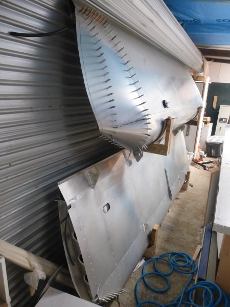

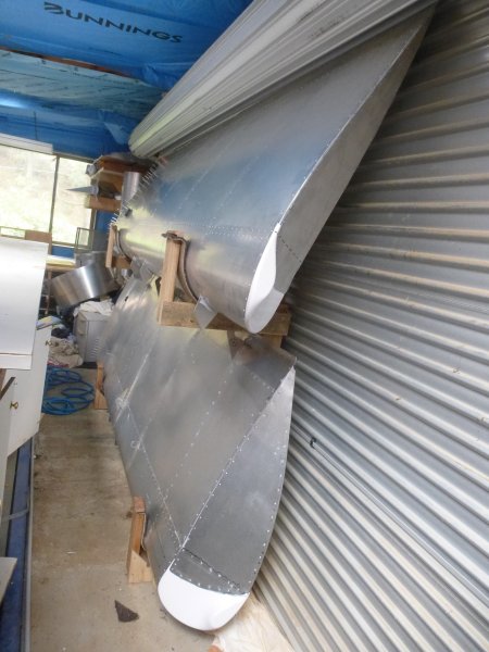

Second wing done!!! That leaves... er... (counting on fingers)... zero wings still to build!
Thanks 80kts.
Slats and flaperons next I think... should be a bit simpler than the wings, in the instructions there's only 39 pages combined for them (as opposed to 178 pages for the wings).
Mind you then comes the fuselage which is half the bloody book.... but as my wife said to cheer me up, "You had to build 2 wings, you only have to build 1 fuselage!"
This has to be the most optimistic comment on building an aeroplane i have read. Awesome...

Second wing done!!! That leaves... er... (counting on fingers)... zero wings still to build![ATTACH=full]37930[/ATTACH] [ATTACH=full]37931[/ATTACH]
