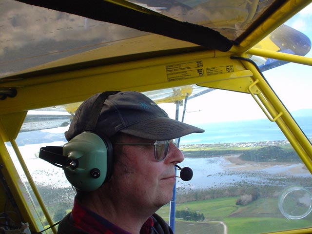

i'm 1.76 so have quite a lot of room to spare. Headset with band behind helps too

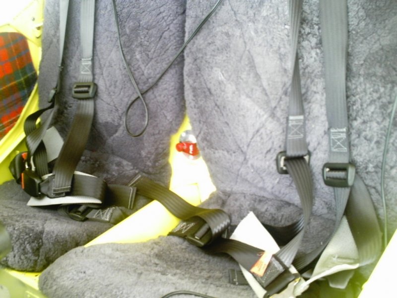

That's an interesting harness setup you've got there. Not a standard 3-point - where do you attach your shoulder straps to?

JB your cabin photo gives me hope. Maybe I'm 6-7 cm taller from backside up. looks OK. With a roof as in #482 I'll be laughing. S
Marty, it was the harness supplied by CZAW, there is anchor points part no 7-FO-4-2CZ for the shoulder straps in the aft of of the extended baggage compartment.
CZAW certified their 701 to European BCAR 'S' they added doublers and increased rivet lines for these attachments. This change was adopted by Zenair in a later revision.

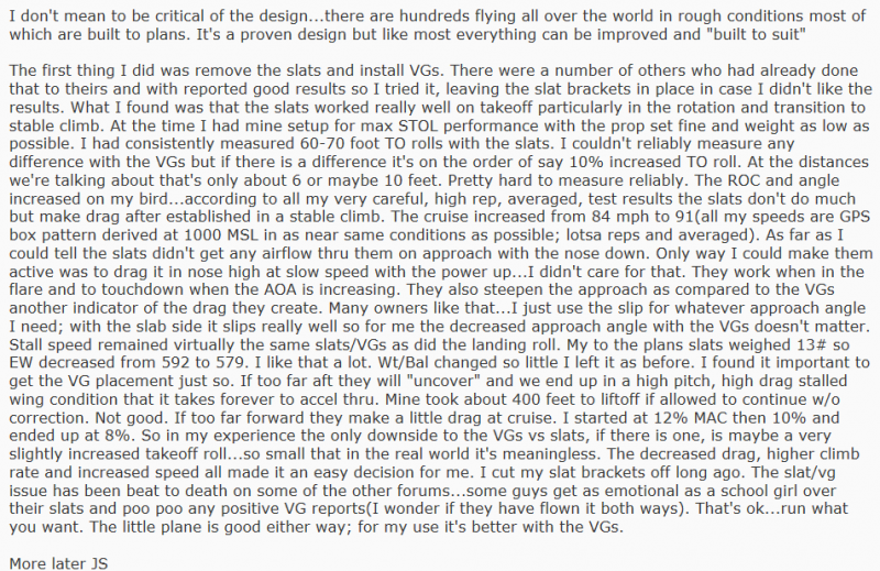

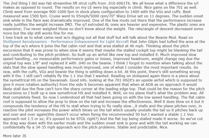

I am sure that this is the post that Bex is referring to. It is so useful, in my opinion, that it is worth reproducing as a screenshot. BUT: read the whole thread to get the whole picture.
