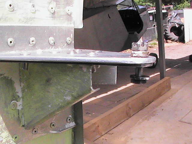

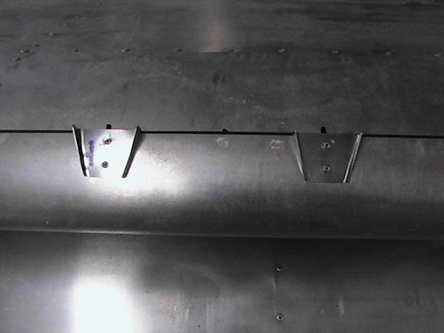

skyfox1 Posted November 23, 2012 Posted November 23, 2012 Hi Phil everything is going well, l have just finished the putting the horizontal stabilizer all back together reinforce the attachment points also put some bolts at the rear hinge attachment also ,l have install the VGs to the elevator so all the wings ,ailerons,tail plane are ready for painting , l am repairing my slats at the moment ,then l will get back to the fuse,l just missed out on the wheels and brakes that were for sale here on the forum so l will have to go ahead with my original plan and put the blackmax brakes on . Still waiting for my pistons from German to finish the rebuild on my 912 got everything else l need the pistons l got were 15 grams different weights so not matching pairs the ones that are coming have been checked. What home work do you have to do for your 701. cheers Geoff.

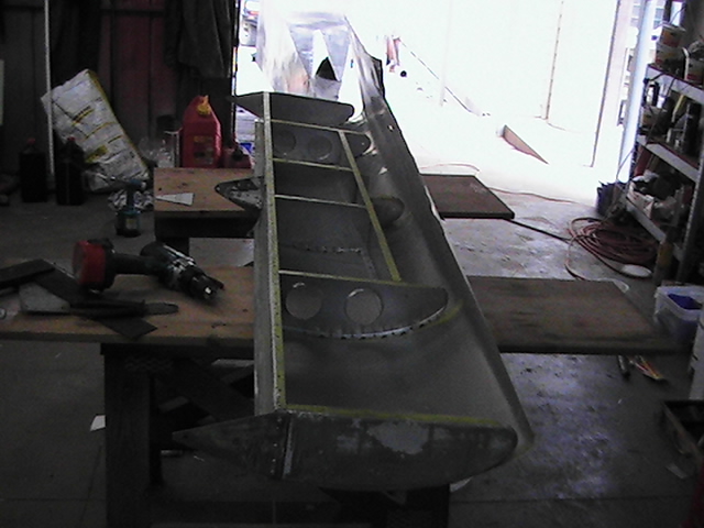

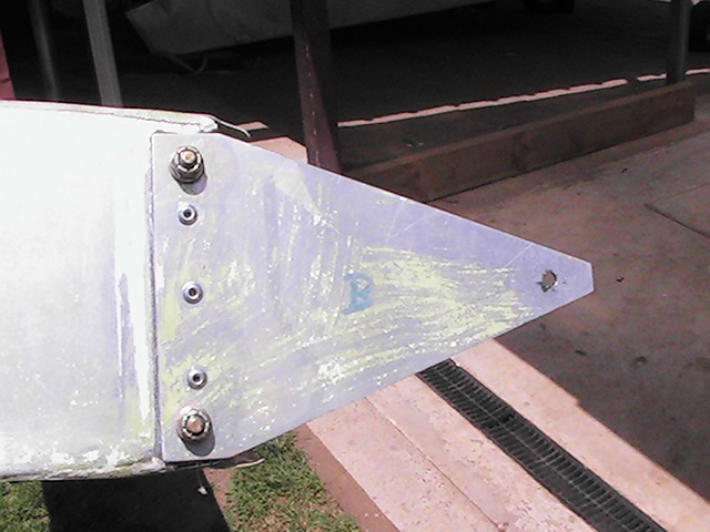

skyfox1 Posted November 25, 2012 Posted November 25, 2012 Hi Phil Here are the pics of the bits l was telling you about. cheers Geoff.

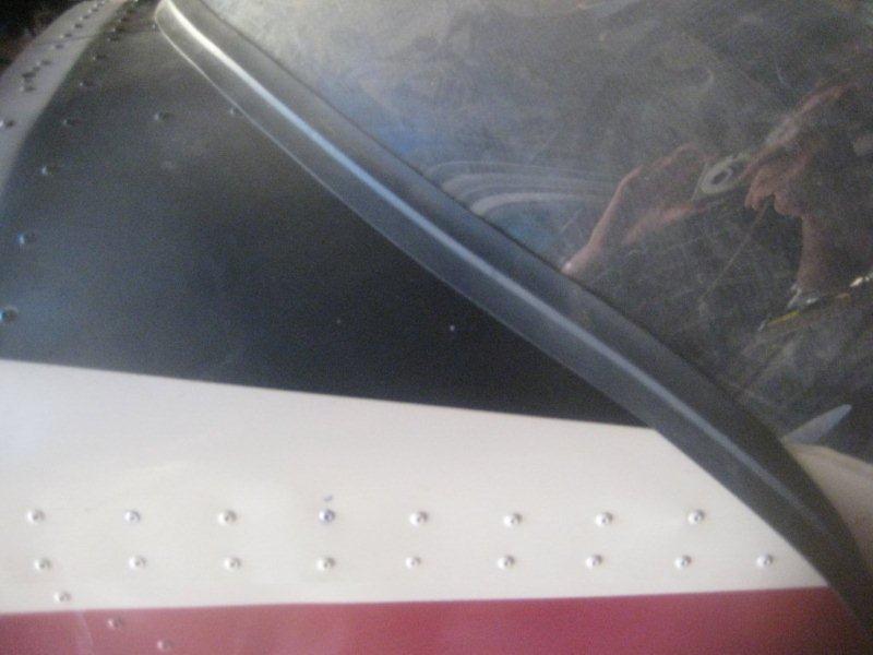

Phillip King Posted November 25, 2012 Posted November 25, 2012 Hi Geoff your mods look great would take me a lot of work to do that got the engine mount on today but seems to high starter motor is higher than the fire wall will ring jab tomorrow have alook at the picks Cheers Phil
skyfox1 Posted November 25, 2012 Posted November 25, 2012 Hi Phil Your engine mount looks very high does much of the engine sit up past it. .What holds the rubber to the fuse on your windscreen. l didn't get a pic of inside the horizontal stabilizer after l had made the doubles for the attachments to the fuse, l finished riveting all back together then l realized l hadn't take them. The other mods l have done l still have to smooth off all the edges get rid of any file marks then l will start painting l have been trying to start the painting then l change something else l have tried to get all the updates done then l find parts that are worn so l replace them list goes on and on . cheers Geoff.
Phillip King Posted November 25, 2012 Posted November 25, 2012 Hi Geoff yes i think its to high comparing to the jab usa site its about 2 inches high going to ring jab today see what they say,Will rivet a strip around the base to hold rubber down. keep your head down you will have a strong little plane when you finish Cheers Phil

Phillip King Posted December 5, 2012 Posted December 5, 2012 Hi Geoff how is your 701 going ready to put some fuel in it yet. I have been cutting 30 mil cover strips to hold my windscreen rubber down lot of triming to get them to fit and watcthing youtube videos on low flying super cubs Cheers Phil
skyfox1 Posted December 5, 2012 Posted December 5, 2012 Hi Phil l got all the paint yesterday to start painting on Saturday its going to off white with home bush red elevators and slats all two pack,l have been moving everything around in my shed so l can make a spray booth, l got my Easy riser down from the roof so l don't get over spray on it and found a rats nest inside the wing another job. My barrels and pistons came today so l can rebuild my spare motor for my Drifter. what are you doing about you engine mount. cheers Geoff. 1

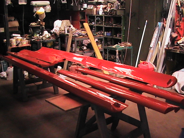

skyfox1 Posted December 11, 2012 Posted December 11, 2012 Hi Phil Started painting today didn't get chance on the weekend went to Yarram and went for a fly in a light wing was good l was hoping to go in the savannah buy the cfi was booked out. How did you go diving get anything . Here are a couple of pics of the slats and ailerons l will give them a second coat. 1
Phillip King Posted December 12, 2012 Posted December 12, 2012 Hi Geoff just got home no diving but got a feed of fish and venison weather was not the best, your slats look great was disapointed i did not catch up when down your way next time. im off to bed been up since 3am Cheers Phil

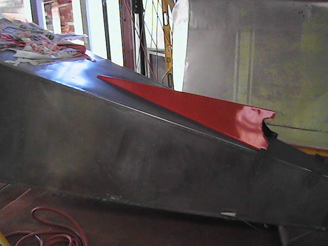

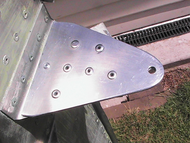

skyfox1 Posted December 13, 2012 Posted December 13, 2012 Hi Phil When your next to your 701 could check what size your rear wing mount on the fuse is mine is 90 thou the old one the new plans show 125 thou.so l am going to replace it l need to find some 6061 T6 125 aluminum. Painted the horizontal stab today plus the top part of the fuse that joins the stab. cheers Geoff.
Phillip King Posted December 15, 2012 Posted December 15, 2012 Hi Geoff had a good chat to Tom last night he has wealth of building knowledge.The l2 that has my jab mtor rang yesterday and offerd to buy the jab, mite take him up on the edea am convinced that the only way to go is Rotax Cheers Phil
skyfox1 Posted December 15, 2012 Posted December 15, 2012 Hi Phil Will you go two or four stroke . l have removed the rear wing mounts from the fuse and l am replacing them with 5083 200 thou aluminum plate bit of an over kill but better than the 90 thou that was there it was for the 503, with the 912 they had to upgraded it ,it ties in all that top frame area so they do a lot more than just hold the wing that whole area is in compression when in flight. Its the same aluminum l used for the for the nose leg attachment. cheers Geoff.
