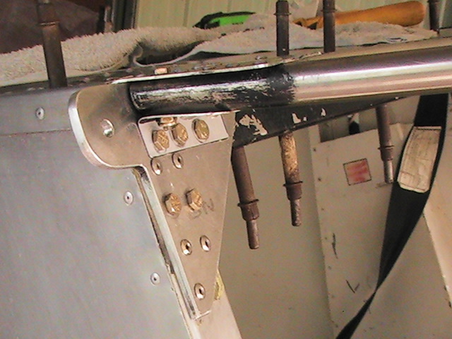

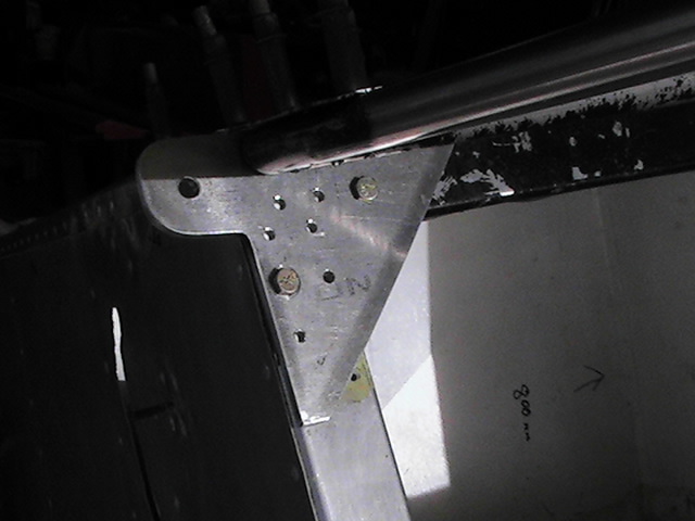

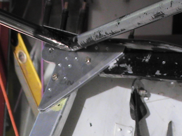

skyfox1 Posted December 16, 2012 Posted December 16, 2012 Hi Phil l dont have that contact anymore but will keep an eye out for one. Where does your rear wing mount touch the wing inside or out of the mount. l made the new rear wing mounts today l have some pics of them sitting in place. l have found an other fault with this 701 one wing between the mounts on the wing is 700mm the other one is 690 mm so the 10mm difference is a lot when l put my new mounts on l measured the fuse and couldn't work out why there was a difference between each side as l made them exactly the same as what l took off didn't realize that it was already wrong . cheers Geoff. [ATTACH]19991[/ATTACH][ATTACH]19992[/ATTACH][ATTACH]19992[/ATTACH]
Phillip King Posted December 16, 2012 Posted December 16, 2012 Hi Geoff my rear wing mount sits on the inside what does it say on the plans, as long as the measurement is the same as the wing does it mater i have some 125 6061t6 if you want some Cheers Phil
skyfox1 Posted December 16, 2012 Posted December 16, 2012 Hi Phil The plans say to put the wing rear mount on the inside but this 701 was made with it on the outside. The 5083 l am using has a shear strength of 27600 psi . You should use the 125 thou and change yours . cheers Geoff.
Phillip King Posted December 16, 2012 Posted December 16, 2012 Hi Geoff thinking of doing the mod is it a big job, cant open your pics cheers Phil
skyfox1 Posted December 16, 2012 Posted December 16, 2012 Hi Phil It is a a reasonable job to do depends on how yours is riveted as mine had some bolts in them which made it easier. l will reload the pics.

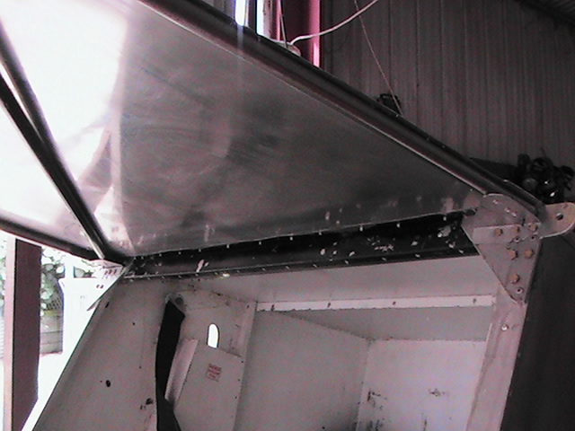

skyfox1 Posted December 20, 2012 Posted December 20, 2012 Hi Phil Have rebuilt many two stroke and four stroke engines over the years its not hard just follow the specifications exactly when rebuilding ,one of the most important things make sure everything is spotlessly clean slightest bit of grime will destroy your work . l finished the rear wing mounts they are all bolted on ready for painting ,l also put the Z bracing in between them it has really stiffen up that weak area. Have you got a price on the engine set up from Tom. cheers Geoff.

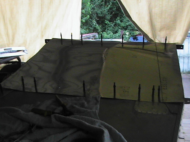

skyfox1 Posted December 20, 2012 Posted December 20, 2012 Hi Phil l have started building the roof l have changed my mine and l am put aluminum one on instead of the lexan l going to put a small window in the center for some visibility . Later on once it is finished and flying l will change a few things do some testing with and with out slats and VGs l will make a beany mod and fill in the gap between the wings ,and l might also change the horizontal stabilizer . But first l want to get it close to the original plans as l can to see how it flys. cheers Geoff.
Phillip King Posted December 20, 2012 Posted December 20, 2012 HI Geoff That is one strong looking rear wing mount hang a cessna wing off that,Im with you will get mine in the air then make little changes i like your edea of putting the aluminum in the roof with a small window, your pics are handy for me thanks Cheers Phil

skyfox1 Posted December 21, 2012 Posted December 21, 2012 Hi Phil Yes there are upgrade to the wing the wing attachment has gone from 125 thou to 1875 thou. 7v2-6 was 25 thou to 32 thou 7v3-2 has a doubler which is 32 thou. Cheers Geoff.

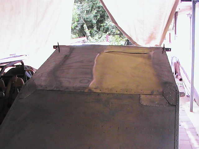

skyfox1 Posted December 23, 2012 Posted December 23, 2012 Hi Phil Finished the roof off last night with the roof riveted in place plus the z brace it is so strong there now didnt put the small window in yet may be later ,l can now paint all of the fus . l am going to re skin the doors and try and bubble them out a bit. l gave the drifter a pressure wash today it was cover in dust kick up by all the tractors in the orchard looks new again . soon as the runway is cut l will be airborne the neighbor wants to cut it for hay so l have been waiting patiently, other wise l would of slashed it myself. cheers Geoff.
