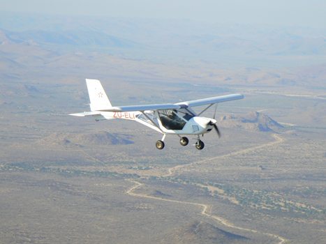

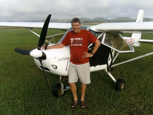

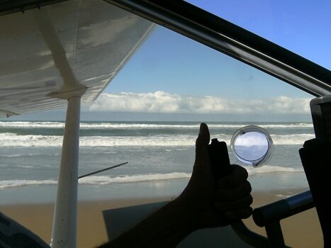

Hill Posted February 23, 2012 Posted February 23, 2012 I have a Foxbat A22 ,have done about 600 Hr on it .It is better than all you have herd .It can fly slow ,it can fly fast (for a LSA fast enough) the doors can cume off for photo shooting .Short take off and landing,lands on the beach. Has ampel room for 2 big people
eightyknots Posted February 23, 2012 Posted February 23, 2012 I have a Foxbat A22 ,have done about 600 Hr on it .It is better than all you have herd .It can fly slow ,it can fly fast(for a LSA fast enough) the doors can cume off for photo shooting .Short take off and landing,lands on the beach. Has ampel room for 2 big people Do you have some pictures, Hill?
