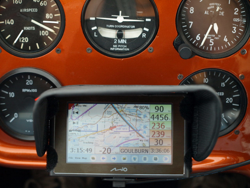

slartibartfast Posted February 28, 2010 Author Posted February 28, 2010 I snapped this today to give you an idea of what it looks like in flight. Note the hood I picked up on eBay. This makes the screen even more readable. [ATTACH]10040.vB[/ATTACH]
deadstick Posted March 1, 2010 Posted March 1, 2010 I can attest to the MIO 370 from Slarti, it is an absolutely outstanding unit touch screen colour the ability to switch between automotive and air it is the best money I have spent, I was tossing up buying a garmin 96 and boy I am glad that I didn't. For anyone thinking of purchasing one of these of Slarti, go for it they are great value for money. thanks again Ross and it was great to meet you finally at Wings over the Illawarra.
