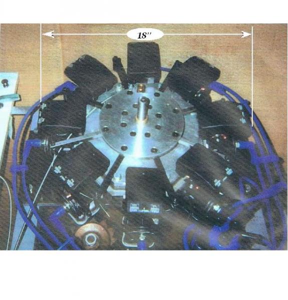

Blackhawk Posted January 22, 2009 Posted January 22, 2009 In late 2009 we will begin production of three different size, High Torque Multi-fuel Radial Piston engines which will be Air-cooled and Fuel Injected. There are very few engine choices in the 65HP to 120HP range at the moment and Diesel engines in particular, are virtually non existent for Recreational Aviation use. We have Patents for the engines already in place for some countries with more to be submitted in early 2009 to give us full world wide protection. Below are the specifications for the three engine designs (all Diesel, but can be configured to run on UL petrol at slightly less HP). They will have inbuilt gear ratios and drive configurations. All engines have a maximum 3000rpm and are designed to have the following drive options; (1) Direct drive (for fixed wing and Gyro's) for all three capacity engines (2) Direct drive with counter rotating shafts (for helicopters, fixed wing and Gyro's) for all three capacity engines. (3) Direct drive with 500rpm on front output of engine and 3000rpm on the rear (for Helicopters only) for the 1600cc and 2000cc engines. The specifications are as follows; CAPICITY ............HORSEPOWER.............. DIAMETER ............WEIGHT 1200cc .....................70HP ............................510mm ................<50kg 1600cc .....................95HP ............................610mm ................<65kg 2000cc .....................120HP ..........................710mm .................<80kg Production cost estimates put these engines at around 15 to 20% less than currently available petrol engines (Rotax in particular) of similar horsepower and considering a diesel has 26% more power than a petrol engine of the same displacement, this makes our Radial Piston Diesel a very viable alternative. We are looking for 'serious' comments from members regarding these engines. We will be relying on your feedback so that we can determine the viability for us to proceed with the production and general consensus that they will be readily accepted throughout the aviation community. I have attached a photo of the Petrol version proof of concept prototype engine. Looking forward to your comments. Regards Graeme

facthunter Posted January 22, 2009 Posted January 22, 2009 Description. It's a piston radial configuration, isn't it? Why do you call it a rotary?. Is it a 2-stroke or a 4-stroke and liquid or air cooled? Lots of questions. The Packard Co. in america built some (radial diesels) in the early thirties. and there was an east european brand called a ZOD. Quite a few German engines were produced as diesels but they were in-line opposed piston. (Junkers Jumo). A rotary is normally regarded as a "wankel" type engine, whereas a "true" rotary is where the crankcase rotates with the cylinders and the crankshaft stays still. The propeller is attached to the engine, and turns with it. Nev..
Blackhawk Posted January 22, 2009 Author Posted January 22, 2009 The engine doesn't have a crank shaft, the pistons are driven by a cam. Hence the term Rotary. They are air cooled, but that might change before production and we can easily add valves for a 4 stroke configuration because of the simple way the engine is designed. They are all common rail EFI. Graeme
gofastclint Posted January 22, 2009 Posted January 22, 2009 The engine doesn't have a crank shaft, the pistons are driven by a cam. Hence the term Rotary.They are air cooled, but that might change before production and we can easily add valves for a 4 stroke configuration because of the simple way the engine is designed. They are all common rail EFI. Graeme what i like about the pistons moving a cam is that a higher percentage of the piston down force is transferred into actual shaft power as opposed to the force in a conventional combustion engine where maximum force in only when the crankshaft is at 90 degrees of the down ward force. being a diesel, i hope you are using forced induction?

geoffreywh Posted January 22, 2009 Posted January 22, 2009 very interesting, usually diesels are "compression ignition" but I see you have spark plugs fitted. do you have any consumption figures? as a radial "looking" engine will it stand fitting "out in the wind" and still be visually appealing? The 120hp looks great....
Blackhawk Posted January 22, 2009 Author Posted January 22, 2009 Geoff, The photo is the prototype petrol version, not a diesel. We've decided to develope the diesel version instead of the Petrol. Flying "out in the wind"................ YES! Graeme
