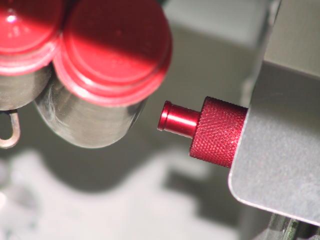

Guest Fred Bear Posted October 22, 2006 Posted October 22, 2006 Hi Guys. Posted this pic for those with Jabiru engines that are interested. Available from Aircraft Spruce in the US. Part number S5020J. AUD$40 + Freight. Makes changing the oil very easy - you don't even need to remove the bottom cowl off a Jab. FAA approved. Easy to use; just whack on a drain hose, push and twist. Only downside is that the outlet is quite small so you need to make sure that your oil is fairly hot, which realistically you should be doing anyway. Regards.

Guest Vigilant Posted October 23, 2006 Posted October 23, 2006 Is there any danger with the drain vibrating loose? With most engine components & vital areas lock wired for good reason (sump plutson Rotax 912) is this a good idea just for the sake of convenience? Just a thought.
Guest Vigilant Posted October 23, 2006 Posted October 23, 2006 Oh and pluts is supposed to be PLUGS 6pm - 2am arvo's - not used to these
Guest Fred Bear Posted October 24, 2006 Posted October 24, 2006 Very Vigiliant Mr. Vigilant! I took the photo prior to fitting the lock-wire to it. There are several holes for fitting the lock wire to it so that you can ensure it stays tight. Personally I'd be surprised if it vibrated off, but you never know.

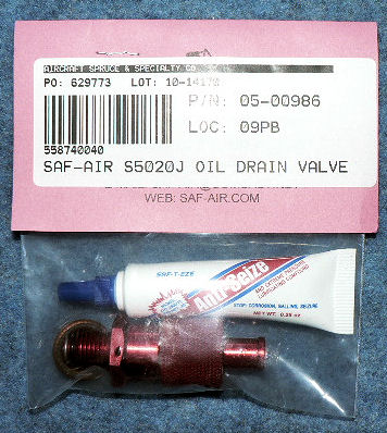

Ross Posted November 2, 2006 Posted November 2, 2006 Forgot to wait. Ordered from Spruce. Total including freight Au$93.36. This is invoiced as the Jabiru version. Regards Ross

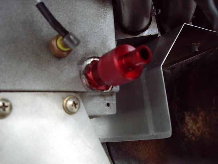

Captain Posted November 2, 2006 Posted November 2, 2006 Mine is on and with the new exhaust on the 3300 engine it sits close to the pipes. Here is a pic from below. I am aware that they push in a fair way when opened and thatshould give room to fit the drain tube. How does yours look Ross? I am in the middle of corresponding direct with Saf-Air as I thought they might make an elbow to go into the sump plug and then attached the drain pointing down. They don't. They offered the option to cut off the hose tail and attach a larger tube over the knurled section. I have sent them the pic and am awaiting more developments. Edit ... just noticed Don's post on this very issue. Where did you get the elbow from Don? I understand that the thread is 1/2" 20. Also noticed your comment about temp Clem. I think Saf-Air spec a max temp which I assume is for the welbeing of the O-rings inside the unit. That's my worry leaving it as it is. Regards The Wagga Geoff Captain
Guest DonC Posted November 2, 2006 Posted November 2, 2006 I had to get the elbow made as the threads are straight - not tapered. Also , I got the same drain plug from AEROWARE NZ in two days for less than $50 ( including ) post!

Ross Posted November 2, 2006 Posted November 2, 2006 Hi Geoff My valve is still in the packet, see above. The photo was taken probably ten minutes before I posted it. You are way ahead of me. I have suddenly also realised that I must do something with the fairings. So a wing prefit makes a lot of sense. However I still have to close up the fuselage. So there is a fair bit of work there. I am on about my third readjustment of behind the panel wiring at the moment (too embarrassed for photographs!). I saw a professional job on a Jabiru panel about two years ago in Wagga. I wish I had taken lots of photos. Regards
Ross Posted November 2, 2006 Posted November 2, 2006 Hi Theo Yes I am sure about the cost. I made the fatal mistake of selecting Fed X-press. So the detail was: Unit price $US31.60 Freight $US37.63 Total $US69.30 = $A93.85 Ouch Next time I will be far more careful. Regards
