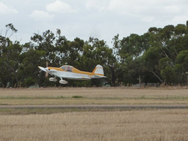

the first Thatcher CX4 to fly in Australia built by Mick Wright had first flight 18/01/2012 at Gawler South Aust this was the 27th in the world to fly
great aeroplane stall 35knots tops out approx 120 knots
Mick W

Congratulations Mick! Any pictures of your baby at all?

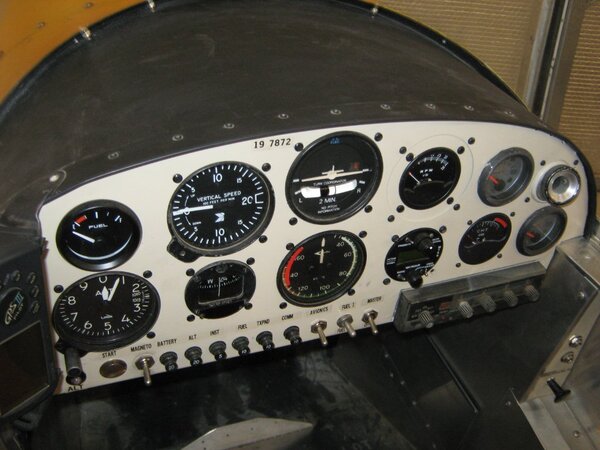

Nice looking CX4. What powerplant and prop combination are you using? I assume you went with the VW? What HP?

I am using 80 hp limbach 2litre (certified VW) Arrow 54 x 46 prop 6hrs flown allin cct area so performance figures not real accurate (goes Quick)
all extrusions ,chrome moly ,tubing assorted hardware from Wicks other bits from Spruce and Great planes all great to deal with Considerable savings over AU prices
even with frieght all sheets from Airport metals Melbourne

fully plans built approx 2 1/2 years i did not keep a record of hours but was only worked on as a part time project
airframe less engine / prop /instuments /avionics approx $10,000
