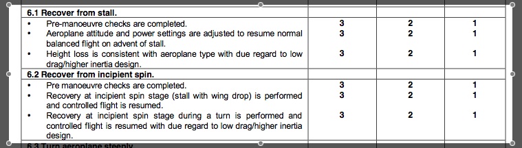

Guest pelorus32 Posted March 25, 2009 Posted March 25, 2009 Interesting - just went to the Ops Manual and had a look at the stalls requirements for High Performance which would cover the P2002. Rotten document is password protected so here's a picture of the requirements: [ATTACH]7444.vB[/ATTACH] Regards Mike
