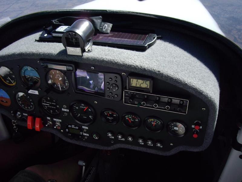

Guest brentc Posted March 29, 2009 Posted March 29, 2009 Ian and others. Cruising around on Saturday to Yarrawonga. 90% power climb to flight level 115. 290 carby jet. Temps as shown. CHT 225 Oil 80 or less (was 90 down low, it was a warmish day) Oil pressure 2.8 EGT 610-620, down low, around 680-700 Indicated approx 102-105 knots Flew non-stop Tooradin - Yarrawonga FL115, 2,900 - 3,000rpm Yarrawonga local flight with Captain, around 15 mins Yarrawonga - Tooradin - 8,500ft Tooradin - Moorabbin - 1,500ft 3.6 hours - 79 litres ~ 22 lph Not as much as I would have hoped for. Was hoping for 24.
