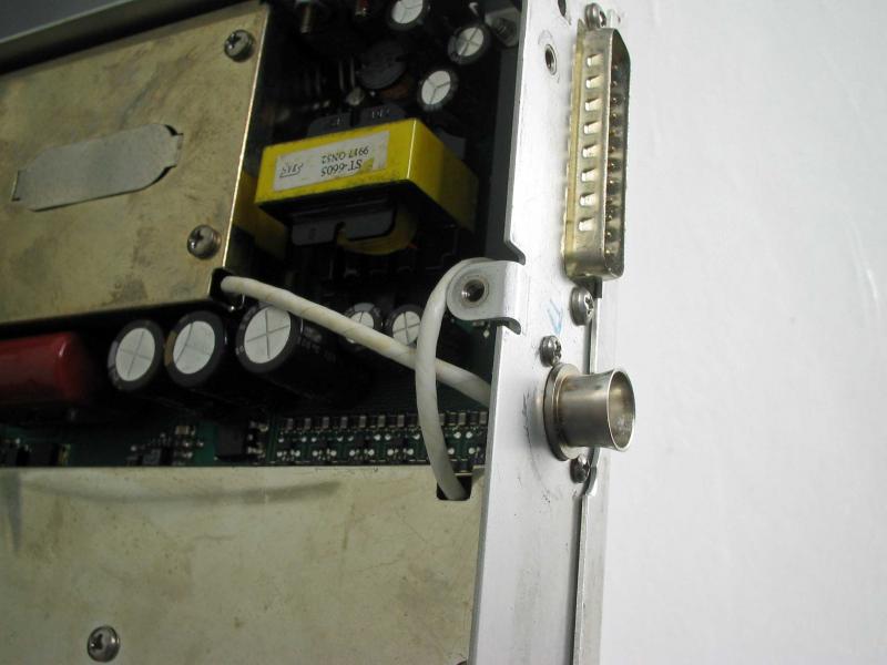

Does anyone know where I can purchase the BNC connector to mate with a GTX 320A?
It was purchased second hand so has zero accessories.

First up that connector is not a BNC connector. There are no lugs. My experience tells me that there is probably a unique rack taht has the opoposite connector and the D connector built in.
The fact that the connector you are looking for doesnt have the bayonete lugs tells me that teh rack is likely not optional and it will be the locking screws/ mechanism on the main box that ensures the connector stays connected.
If you wanted you could get a tech to change the connector to a panel mount connector that could work standalone, BNC in that case will likely work fine. That said, I cant count the pins on the D connector or see if it is in fact just a generic D connector so would want to see that 1st to make sure that changing teh RF connector is just one of 2 required connector changes....

Thanks Andy - if there's no commercially available connector I'll just source a panel mounted one from Jaycar and change it over myself.....
