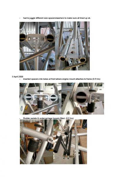

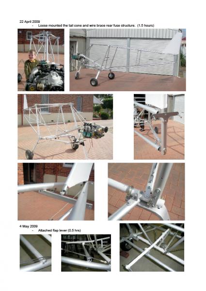

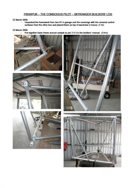

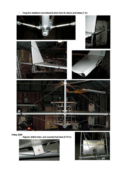

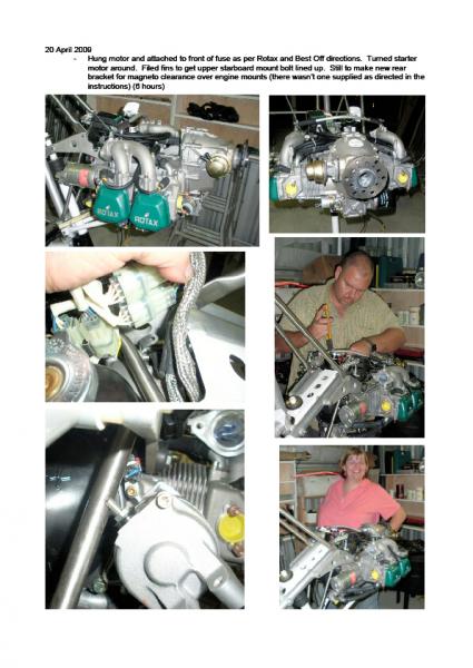

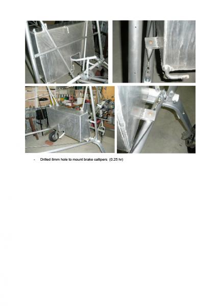

Attached are my pictorial builder's log. I will add to it as I go! Enjoy!

Can't tell from the photos but if you're using the white plastic spacers it will pay you to swap them out for the black ones.

No! I'm still using the white ones why?
We had considerable trouble with ours cracking and splitting before we had finished the build. Turns out they were a known issue and a lot of people replaced theirs with the black ones - from memory they're available from Flylight in the UK Flylight Airsports Ltd. - Tuition
Greg Robertson (Skyranger Swift) in Victoria just went through the process of uncovering his fuselage and replacing his and eventually I'll have to do the same 049_sad.gif.af5e5c0993af131d9c5bfe880fbbc2a0.gif.
Thought it might save you the grief....
Cheers.........Doug
