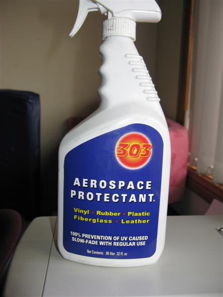

drifter_driver Posted May 21, 2009 Posted May 21, 2009 303 uv spray 303 is another good uv spray which does'nt seem to attract any dust but have to be applied every 6 months to keeep it effective. 1 leter will give you two coats on a drifter. also does'nt add much weight to the aircraft either
hihosland Posted May 21, 2009 Posted May 21, 2009 I used 303 protectant on my Skyranger then left in in a hangar while I was OS for 6 weeks last winter. When I came back my aircraft was covered in mold/fungus wherever the 303 had been applied and the un treated Thruster in the same hangar that also hadn't moved for the 6 weeks was clear of mold. in my experience it is fungus fodder Davidh
drifter_driver Posted May 21, 2009 Posted May 21, 2009 I hav,nt had any fungas issues with 303 for last 6 years of its use. I wash the aircraft, dry it then apply 303 wiping it with a cloth and leave it out in the sun to dry for few hours. may be the hangar I am using is not conducive enough for fungas (its well aerated-no doors)
Vorticity Posted May 21, 2009 Posted May 21, 2009 I had the opposite experience with a drifter. I cleaned the skins, dried them out thoroughly and treated the uper surfaces only. I came back after a month or so away with work to find spots of mould underneath the wing; where I had not treated with 303, and no mould on the top. What I did find was pigeon crap on the wing. Thankfully because I had treated them it was easy to get off. I ran over one by accident while leaving the strip so I guess we are even.

xair1159 Posted May 22, 2009 Posted May 22, 2009 A good number of people (including me) used 303 on dacron over here in Ireland/UK and ended up with mould problems. Might be OK in a warm dry climate, but I wouldn't recommend it if there is any real humidity around. I have the photos to prove it if required. PITA to remove the black spots, the local agent for 303 advised Milton baby bottle sterilising fluid diluted 4:1 in warm water and left on for just long enough for the spots to disappear - about 5 minutes. Rinse very thoroughly with plain water, drip dry in the breeze/sun and then fly it for a final blow dry. Did the trick, had the a/c for 3 years after with no ill effects or fabric problems. Nick

jordy Posted May 23, 2009 Posted May 23, 2009 A good number of people (including me) used 303 on dacron over here in Ireland/UK and ended up with mould problems. Might be OK in a warm dry climate, but I wouldn't recommend it if there is any real humidity around. I have the photos to prove it if required. PITA to remove the black spots, the local agent for 303 advised Milton baby bottle sterilising fluid diluted 4:1 in warm water and left on for just long enough for the spots to disappear - about 5 minutes. Rinse very thoroughly with plain water, drip dry in the breeze/sun and then fly it for a final blow dry. Did the trick, had the a/c for 3 years after with no ill effects or fabric problems. Nick PITA ??? nick what is pita.I've had a similalar experience with the 303. Loved the look and the enhanced performance on the Drifter (503) (and i'm a big bugga!!) but a week later all the yellow section of the sails had black spots everywhere.............. thought they where there to stay until i read your post. Tony, armour-all or U/Lam in a high humidity area?
xair1159 Posted May 23, 2009 Posted May 23, 2009 Jordy, PITA = pain in the ass, not a type of bread. Usual caveat on the Milton, it worked for me, but use at your own risk. I diluted the Milton 4:1 in warm water, brushed it on an area with a soft bristle car wash brush, watched until the black spots faded which took about 5 minutes and then rinsed off with a hose. Repeated until all the skins were done and then thoroughly rinsed the whole thing CAREFULLY using a pressure washer with the nozzle set for a wide fan, not a concrete cutting jet, and held well away from the surface. Let the breeze and sun dry it and make sure no water trapped anywhere, re-lubricate any moving parts or hinges before flying it. As I said, no problems or significant fabric deterioration in 3 years afterwards. If you search on the Xair forum there was a long thread about it at the time and my photos are filed. Nick
